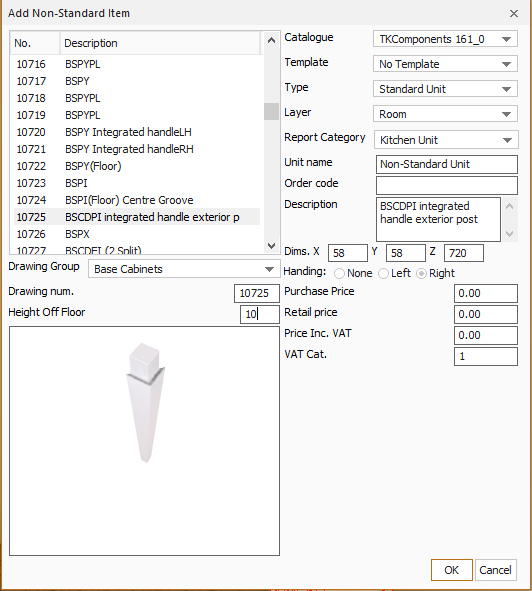

Found it!
Same process, drawing number 10725.
I also found a small curved version, as some suppliers offer this as well, drawing number 10720 & 10721.
When you add them in to a design, save them individually as a grouped item with the supplier code as the saved name, so you don’t need to go through the process each time you want to add them to a design.
This should sort you out.
