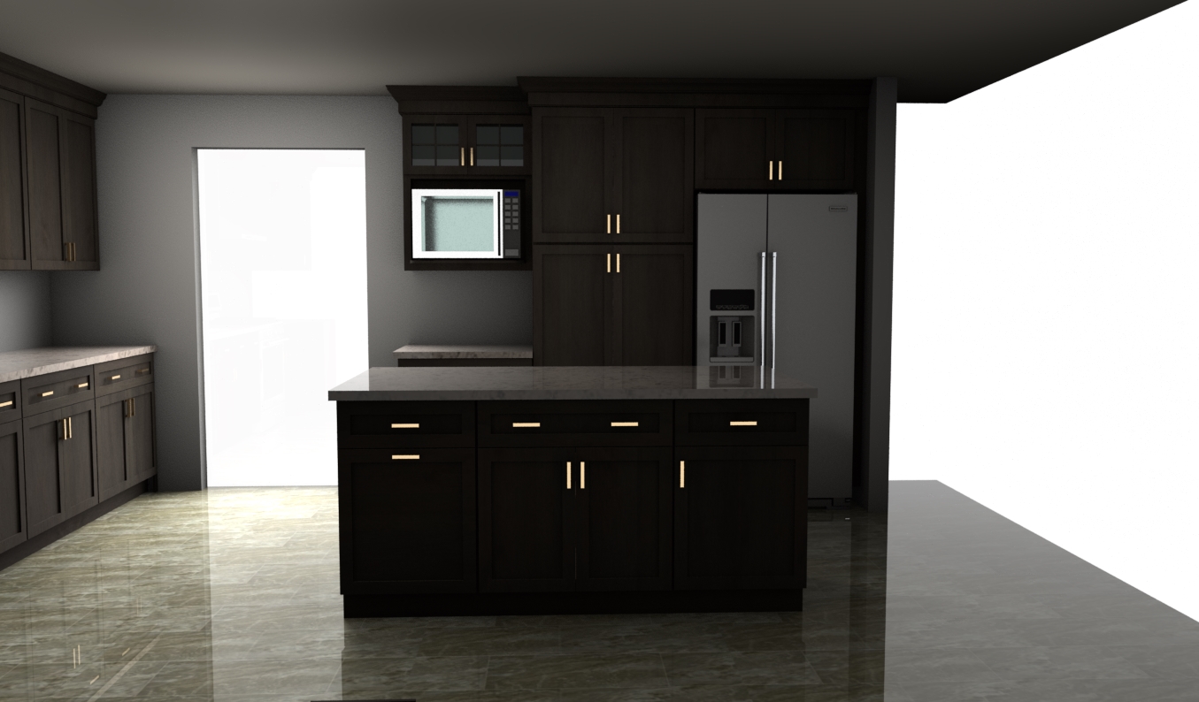

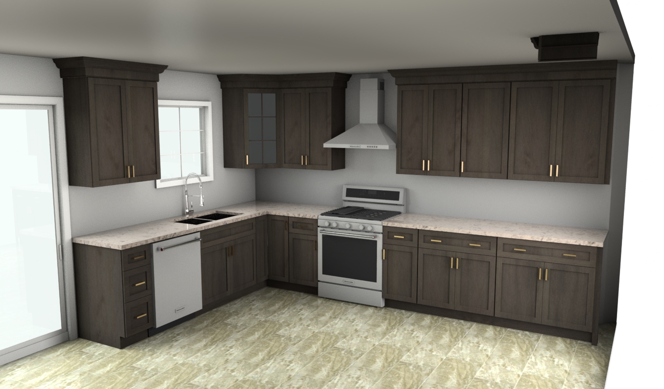

      I upgraded to 2020 Design Live recently, and I can’t seem to make EZ render work correctly.  It was advertised as automatically adjusting the lighting to make the renders more realistic, but alot of times it makes my renders so dark you cant see anything.  I attached 2 pictures from the same design, one of them looks good with the lighting, and the other is totally dark.  What am I doing wrong?  I adjusted the ambient lighting to be at the highest setting already.

      The reason the View-2 rendering is dark is because there is not enough light in the room.
      There are 2 ways to lit up a room:
      1) Through a portal (like windows or doors)
      2) Lights artefacts (like recessed lights on ceilings and cabinet lighting)
      In this specific example, the only source of light is the door entrance at the back (no light is generated from the opening on the right-hand side).
      The closer your projects reflect the composition of a real room, the better EZ render will react.
      Hope this helps! : )
