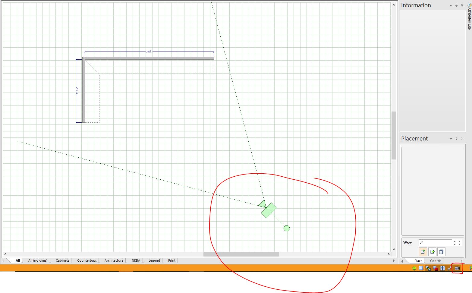

Hi Rob,
To center your design on it is rendered, double click on the Scrolling button on your mouse. No matter where your design is in the rendering, double clicking the scroller with center the image on the screen.
It is also possible that the camera on the floor plan is not facing the direction of your design. To make sure of this, click on the camera button in the bottom right-hand corner of the program to turn it on on the floor plan(see image). When the button had a grey background, it is on. Now right click on the camera to fix its height and its tilt to make sure it is looking directly at the design. Now when you render the file, you should see your cabinetry.
If this didn’t help, then its possible this might be an issue in this file particularly. In this case, you can copy and paste the design on a new floor plan and test it out or you can contact us by calling 1.866.697.2020 to have an agent take a look and see what’s going on in there.
