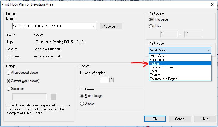

      My computer was wiped and I had to re install 2020 and now when I print elevations of my design its showing my crown moldings are straight green lines and in layouts my toe kicks and countertops are showing also in colored lines. Before they were printing as they were actually going to look and in black and white. Surely this is a simple fix in settings that I am missing but I’ve searched and found nothing. Any help is appreciated

      Try printing in hidden line mode instead of work area and it should resolve the issue.
