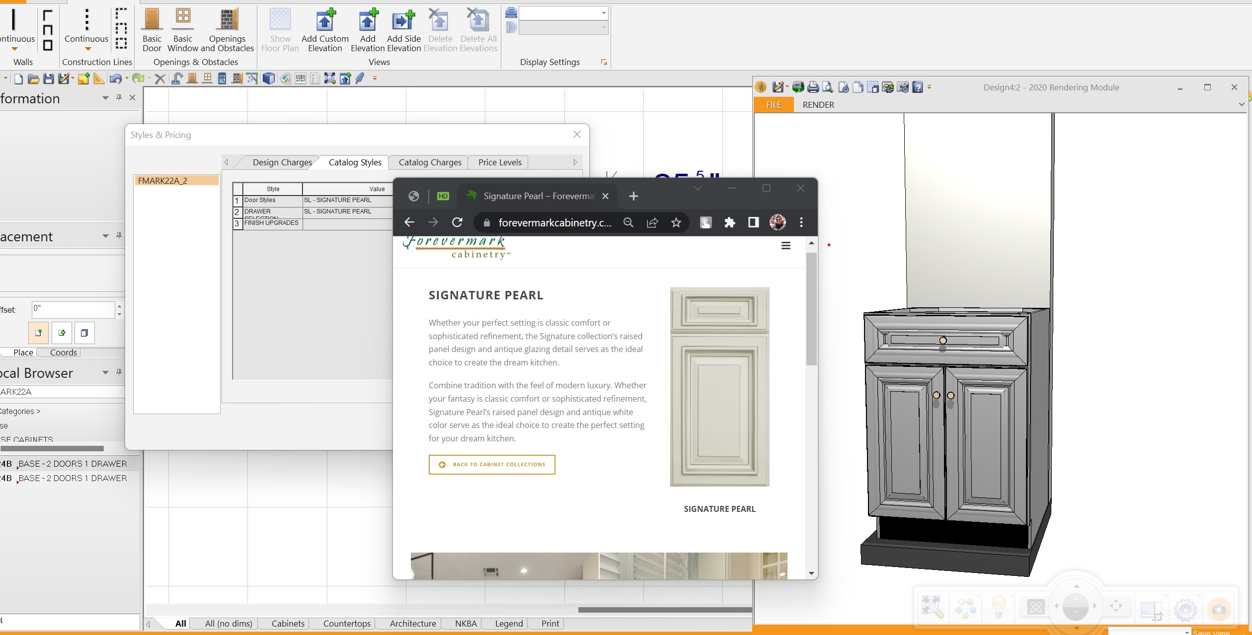

      What to do if the color in the manufacturer’s catalog does not correspond to reality.
      For example, Kitchen Cabinets catalog from TSG Forevermark.
      Color Light Gray- looks like Light Blu,
      Color Signature Pearl – looks White, but must be more Yellow.
      and more colors.
      I can make all the colors that I need myself, how can I access the catalog to do it 1 time.
    • October 14, 2022 at 12:02 pm #376407
      HI Roman,
      I’m noticing that you are using Redway 3D as the rendering engine and using texture with edges as the rendering mode. What I would suggest is to add more walls to the drawing so that it produces more light in the design. I’m thinking that because there is only one wall, it is only producing light on top of the unit making its face darker. I would also suggest trying to use Texture to see if that would portray the correct colour.
