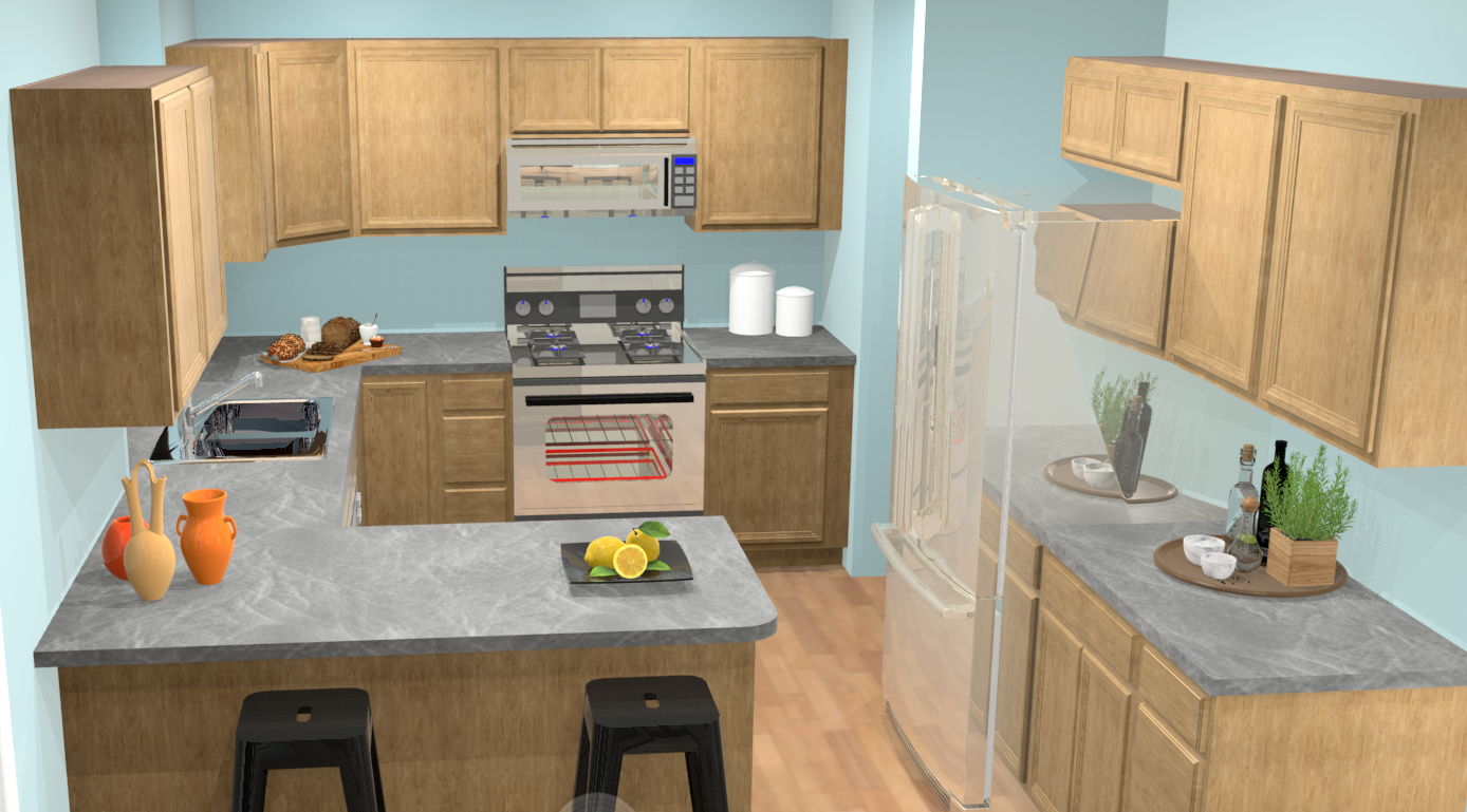

Appliances in Design will generally be reflective. The only thing we can do is create the rendering into a high quality render. Doing this will add the rest of the details that the design is missing. To create a high quality render, first create a perspective view and then click on the camera icon on the bottom tool bar.
Attached below are renderings I had created, one regular and one high quality so we can see the differences.
