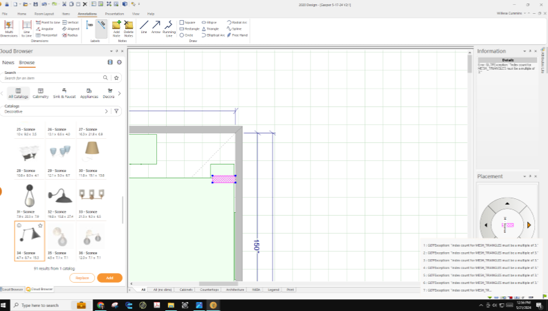

      I’ve been getting this error a lot within the past week when I attempt to place cloud decorative items into my drawing. See the attached picture, bottom left error code. “GLTFException: Index count for MESH_TRIANGLES must be a multiple of 3”.
      Any ideas how to correct this?

      Yes, I have had the same error! We all have been trying to figure it out on our team.  I would like to understand how to fix this.

        I downloaded and ran the most recent version of the clear cloud cache tool and it worked!
