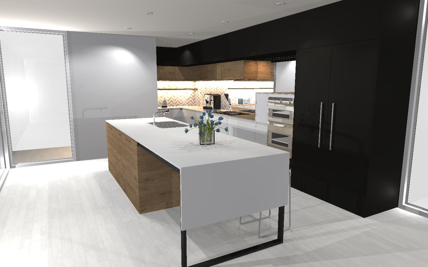

      Hi! As much as I love using 2020 Design, I get really frustrated with the time it takes to do even a simple render once my design is full of imported textures. Is there anything I can do/check to speed this up?
      The image attached took 12 minutes to come down as Medium Quality and it’s still not great 🙁
