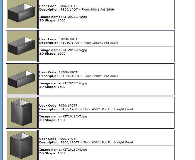

Is there a way to generate a list of my all of my company’s 2020 catalog(or at least just all of the User codes)? I’ve considered doing it by hand, but that can’t be the most efficient way – right? Ideally, I would like to include attributes in the list too, but that is not as necessary.Thanks in advance!!

Mike LangensiepenPilot ProWhen you create a catalog, there is an option to generate an html list of the items in the catalogue along with pictures.
Try searching your C Drive for ItemList.Html and once you find the one that shows up against your catalogue (there may be a few such files) then double click it and the web page will open and you can print the list.
Your version will actually be under C:/ProgramData/20-20 Technologies/Cat/Common/YOURCATALOGNAMEHERE/Multimedia/ItemList.Html
If you know how to edit html (MS Word or mny other free tools), you can blow the pictures up and re-organise the list etc.
See attached screencap
