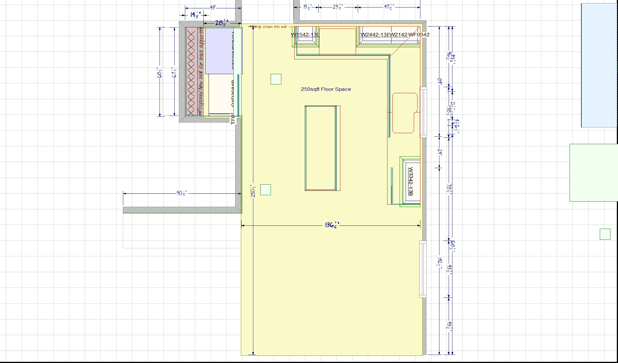

As you can see, when saving a tab as an image, the saved image comes out with missing base cabinets but you can see the image from the Snipping Tool, it shows fine on the plan in 2020. I’ve tried adjusting the Surface Area below the base line so that the surface doesn’t interact with the base cabinets but it still eliminates the base cabs from the Save As Image product.

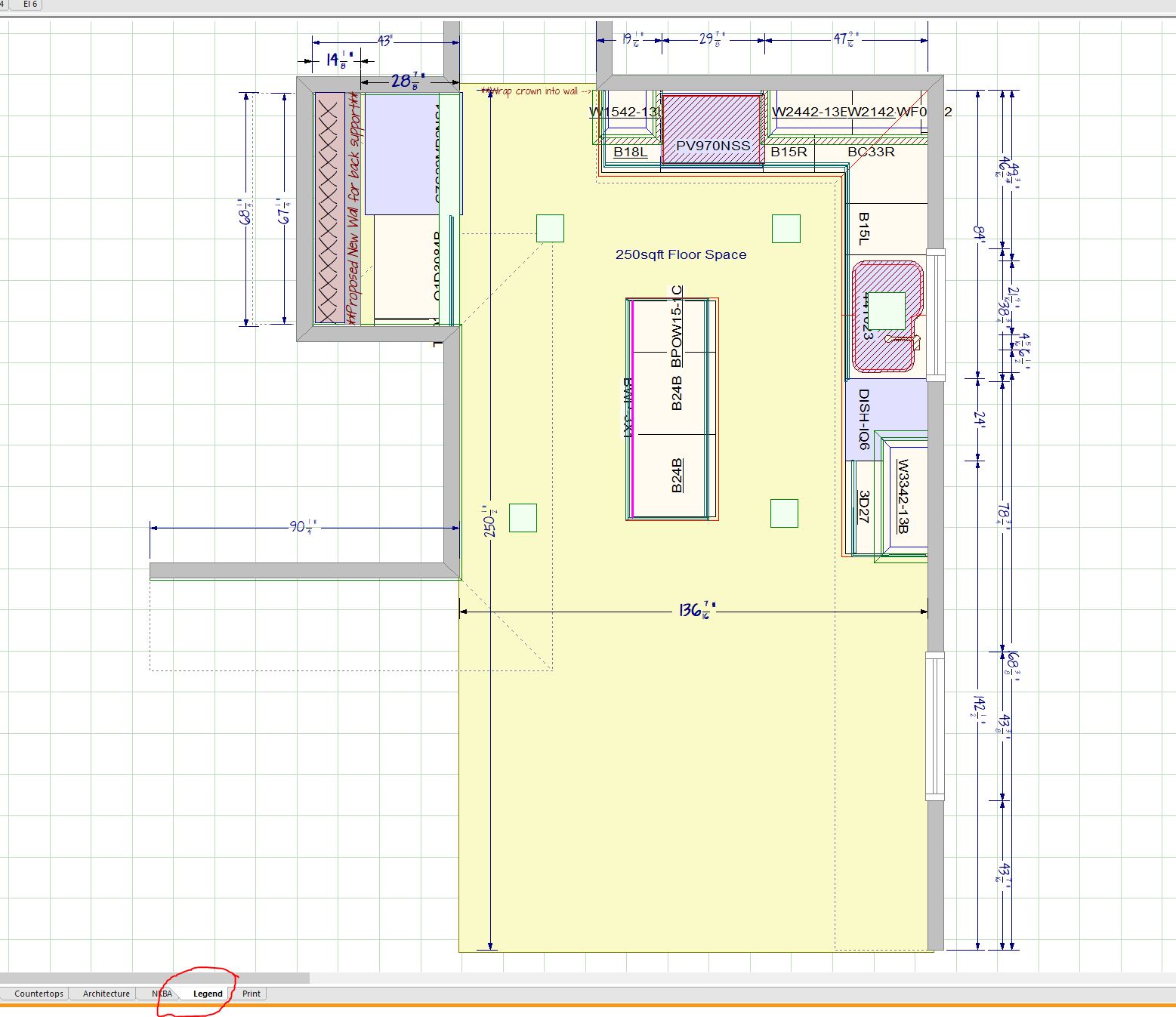

Also, you can see in another screen shot I grabbed, the LEGEND tab changed to having cabinets info shown instead of item #. It seems to be going back’n forth occasionally. Have to click off the tab for it to go back to normal but will go back to screwing up again after a while.

We are aware and have marked the surfacing issue down as a bug to later be fixed. As a suggestion, rather than using the surface tool to set a flooring material, you can set the material from within the rendering. HERE is an article that explains how to change the default flooring texture for the program and for individual designs.
We are also aware of the ‘selection’ issue regarding lines and dimensions. At the moment the only work around for this would be to right click to select the line or dimension.
As for the issue with the Legend and the issue with the surface cutting into molding, would you be able to send us a copy of the design in question so we can take a look and see what’s going on? You can send it to residentialsupport@2020spaces.com with some information.
