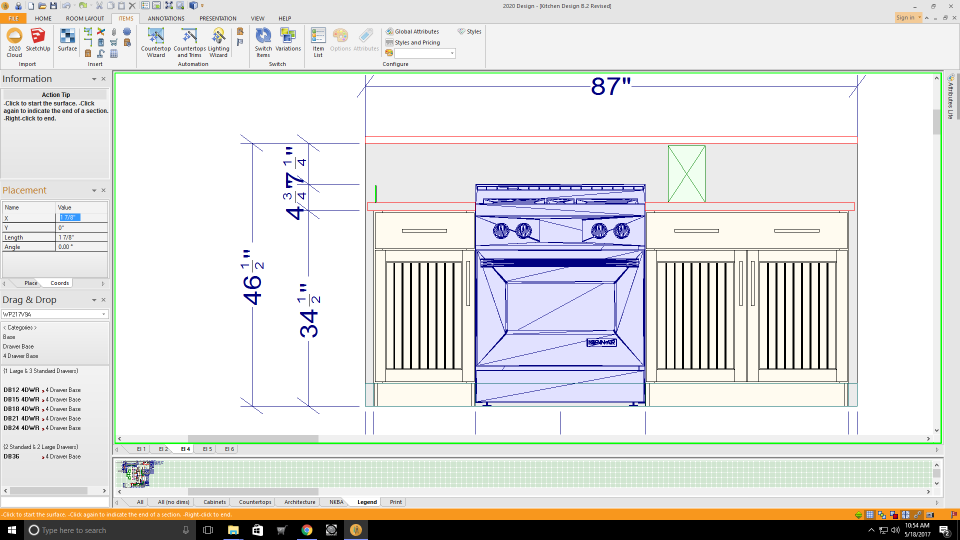

ParticipantWith 11.7, is anyone else having issues with the object snap tool? I cannot seem to snap onto any object’s corner without my lines/shapes automatically offsetting in a different location!
For instance. I’m trying to use the surface tool to calculate backsplash sf and it will not snap onto the edge of my countertop. So I turned object snap off, put my cursor on the corner of the countertop and it still offsets the surface line.
If anyone can tell me a way around this, it would be much appreciated.
May 18, 2017 at 11:35 am #131048
Neil WilsonParticipantHello Willesa,
It sounds like your Area snap is on. It is the button that looks like a grid in the lower right. Turn it off and it should resolve the issues.
