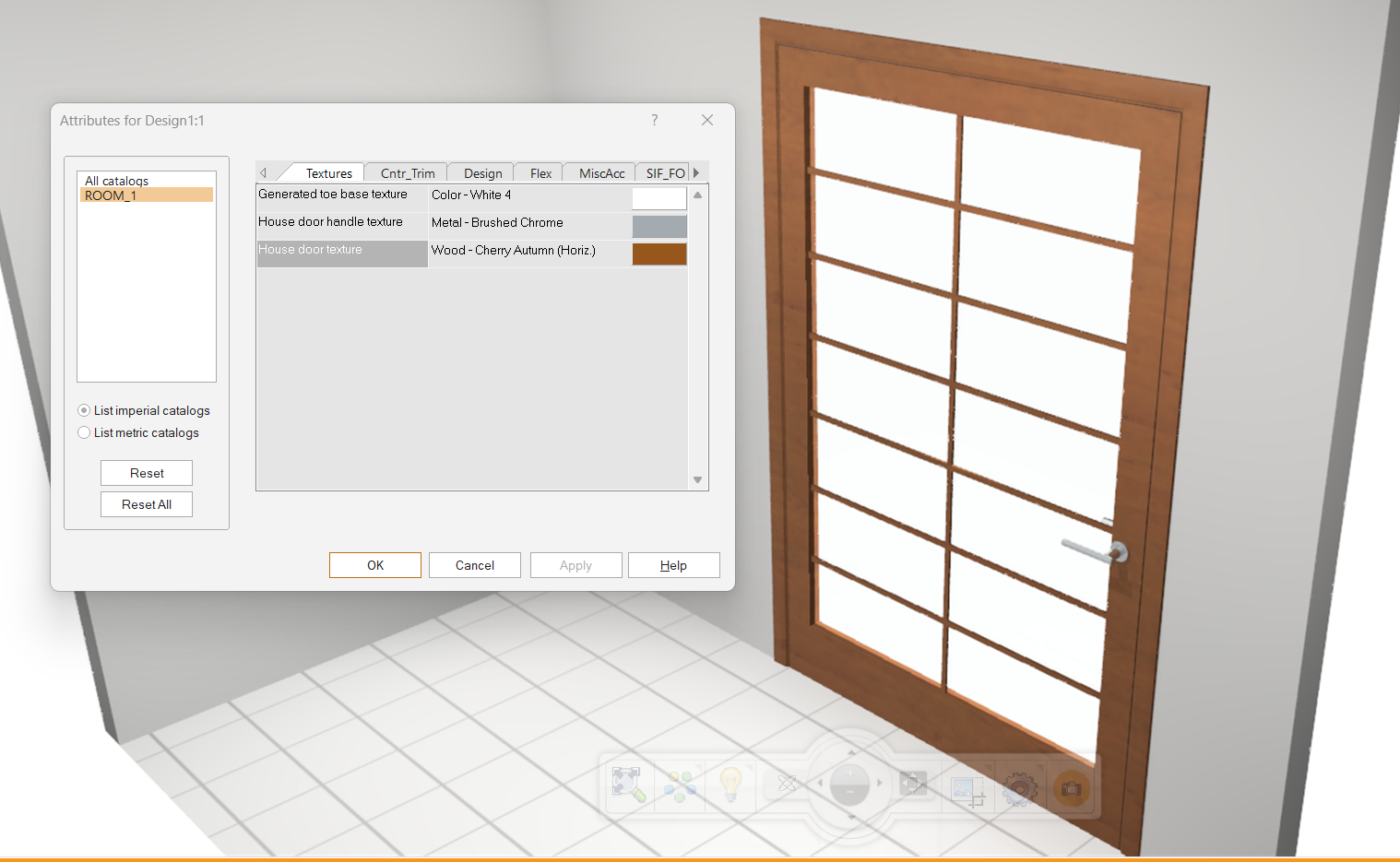

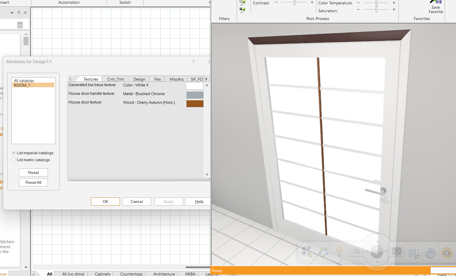

After a bit of testing, I’ve found that this was an issue in the version 12.5.1.32 regarding certain textures and how they apply. The issue has been fixed in v13. I tested the Wood – Cherry Autumn (Horiz.) texture in v12 – turned out horrible, and in v13 – worked perfectly. See images below.

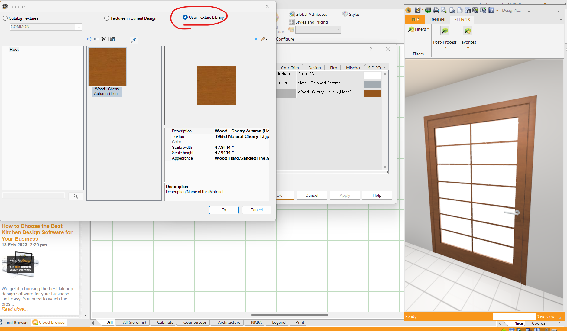

I had found a work around to get it to work in v12 for you. When you have the texture library open, right click on the texture you want to use a click ‘Copy texture to User Texture Library’ and then apply it from your user texture library. This will make it work in v12 🙂
