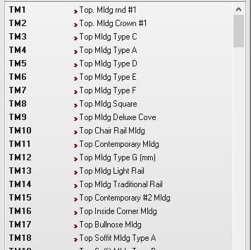

Add Crown molding to walls? To Parent Forum October 18, 2017 at 11:22 am #154155 Chris BlackmanParticipant Is this possible? How? October 19, 2017 at 11:57 am #154293 Neil WilsonParticipant Hey Chris, I know there are Wall moldings in the Sample catalogs that will apply directly to a wall. You can also use the line or running line in Annotations and build the moldings and then move them into place manually. Neil October 19, 2017 at 8:48 pm #154326 Mike LangensiepenPilot Pro Also the UNDRGRND catalog has a great selection of mouldings that can be used. Get the catalog here: https://www.2020catalog.com/downloads/UNDRGRND.zip UNDRGRND also has a great Valance Wizard. Attachments:Mouldings.jpg October 24, 2017 at 11:11 am #154709 Chris BlackmanParticipant Thanks. I didn’t look in the underground. Should have. Also the running line thing I should have tried. You must be logged in to reply to this topic. Share this Post
