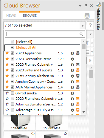

      Favoriting a catalog: Click on the Star next to any catalog to have it favorited. You can them click on [Select All with the star] to search only in your favorited catalog -See image below.

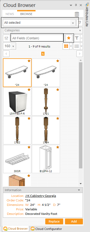

      Favoriting Items: Click on the Star on the preview of the item to have it favorited. Once you have your items favorited, you can always find them easily by filtering out those favorites! To filter out the favorites, simply click on the Star next to the ‘All Fields (Contain)’ bar. Do note that when you are looking for the favorited items, make sure you have ‘All Catalogs’ selected in the cloud browser and make sure there is no filter set in the ‘All Fields (Contain)’ bar -See image below.
