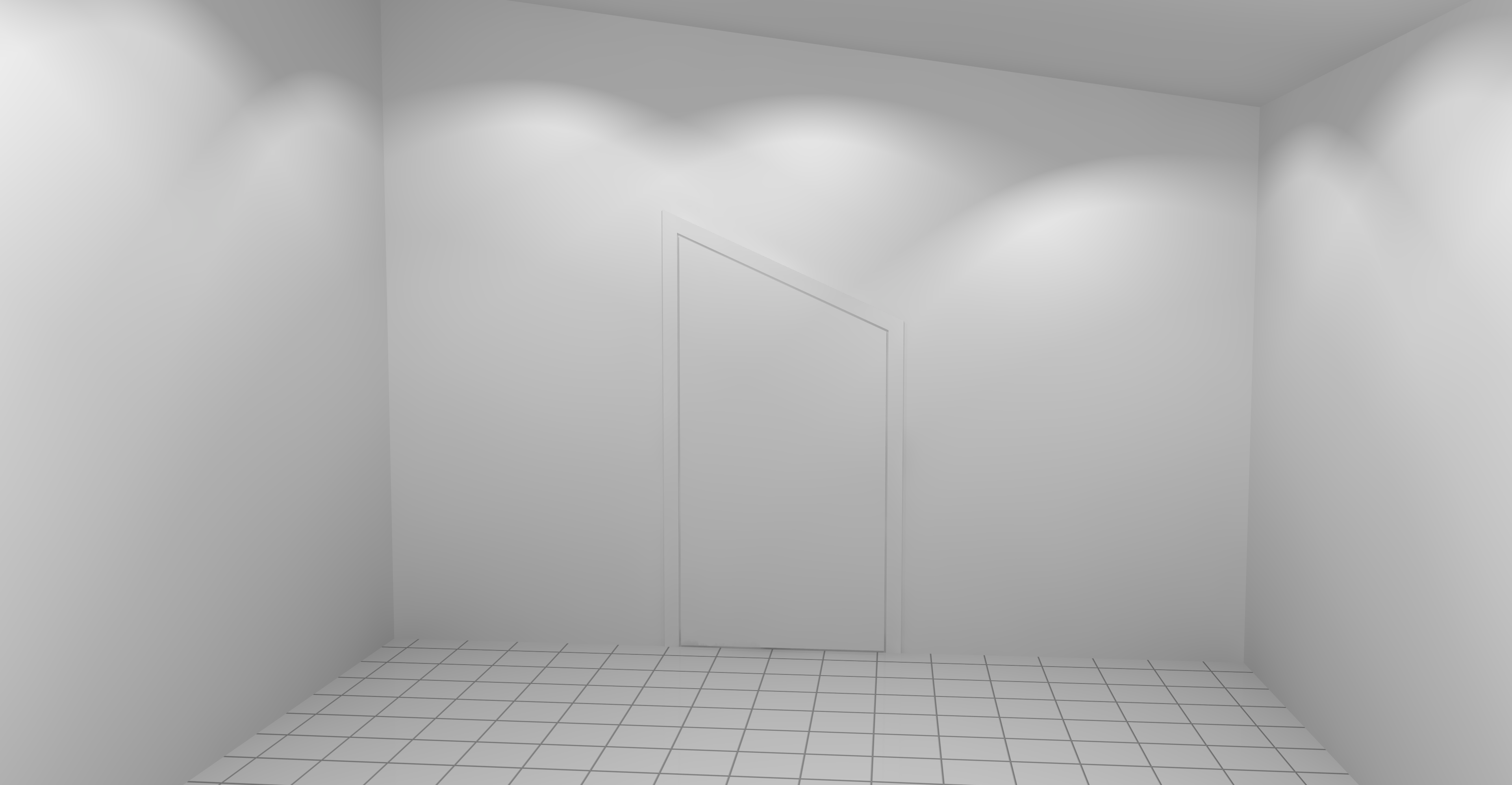

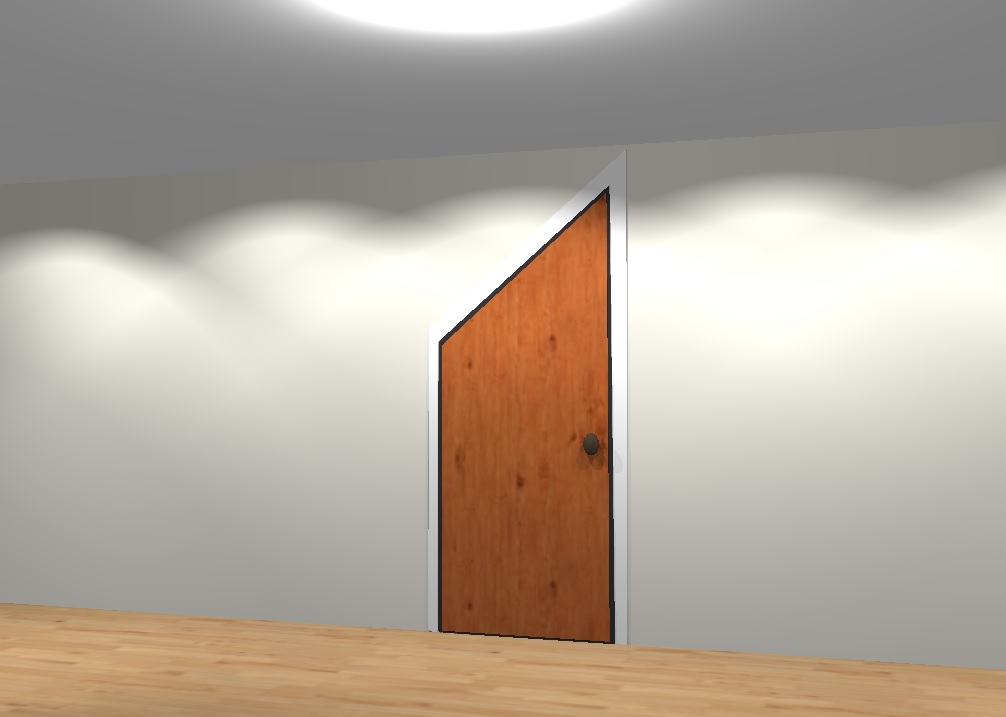

March 25, 2021 at 3:40 pm #321205jacky kreijkampParticipant
This can be easily done in Sketchup. I have made i quick angled door and imported it in 2020, make a cut-out and place it. 5 min off work.
May 14, 2021 at 5:55 pm #330536Ariana ThompsonParticipant
This was quick and dirty – but I did it with Surface.
