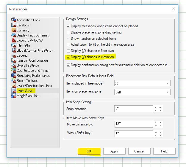

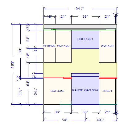

      Also maybe you know, when I see the cabinets elevations I don’t see all lines of the cabinets and drawers, only the sizes. Please see the attached image. How I can fix it? Thank you
      Natalia
    • March 4, 2020 at 1:00 pm #272044
      Hi Natalia,
      To view your elevations in 3D, simply go to File > Preferences > Work Area > Display 3D shapes in elevation. Be sure to check off the option and then you can “OK” the window away and see the door styles in the elevation!
      Check out the image I’ve attached.

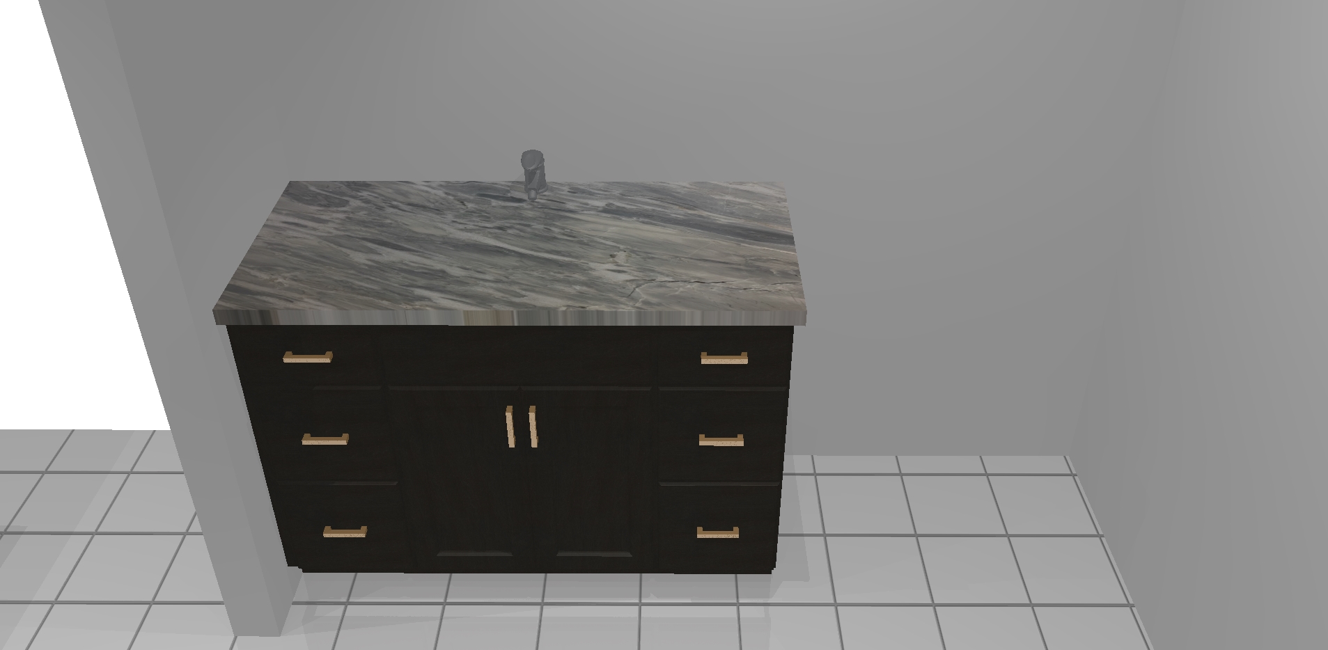

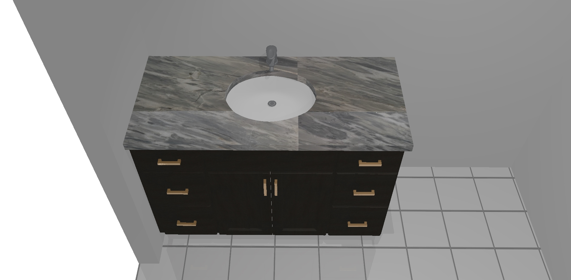

      Alex
      I appreciate the suggestion, but the Persian rug is not a workaround. It does not work with sinks. Please see the attached render.
      It is essential for countertops to have the ability to set the texture’s start point and rotation manually (like SketchUp does). I frequently take pictures of actual slabs of granite, quartz, or marble and use them in designs. It is a great frustration to not be able to position the textures.
      If the 2020 team is reading this, please consider this a feature request.  Thank you!
