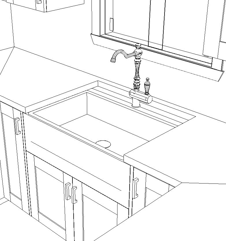

September 16, 2016 at 6:21 pm #101496Danny SteigerPilot Pro
Here’s a funky new one… I’m putting in a basic apron front sink, but no matter how many times I edit the shape of the countertop it always springs back to being too far back (see picture attached). It’s a standard sink from the 2020 plumbing catalog and countertop using the wizard with 2020 room catalog.

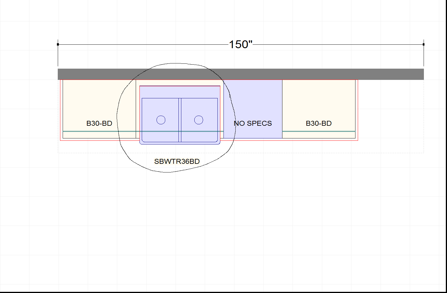

Hi Chuck,
I’ve tried drawing it manually and everything looks fine until I click the green check (done editing). I included an attachment that shows how I’ve manually drawn the countertop around the apron front sink (left picture), but then when I click the check mark it bring the countertop back about 4″ (center picture). Then if I go to edit the shape again it gives me lines all over the place (right picture).
I’ve used apron front sinks in hundreds of designs, and this is the first time I’ve run into anything like this.

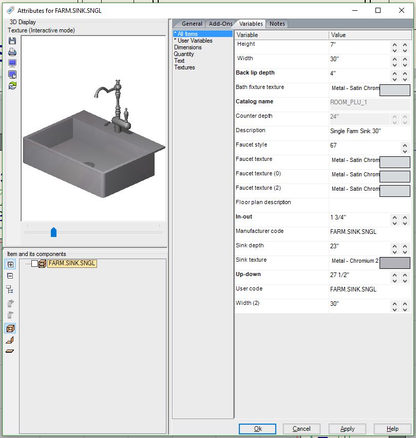

September 19, 2016 at 10:30 am #101822Danny SteigerPilot Pro
No spacing that I see in the attributes; it does have “Back lip depth,” however when I change that it only shrinks the portion that the faucet attaches to, but still has the countertop going behind it. I attached a picture of the attributes.
