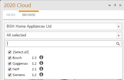

Pilot ProMost of you may know this already but for any Australian users here, please try changing your profile Market Region to the United Kingdom, then sign out of and back into the 2020 Cloud in Design. You will see a LOT more appliances and accessories that are relevant to our clients. This is becoming a quite important feature to my designers.
https://myaccount.2020spaces.com/MyProfile
Also be aware that certain brands are grouped together – see attached image.

2020 ModeratorThanks Mike, it’s great to hear that you and your designers are seeing the current benefits and future potential of 2020 Cloud. Just to add to your comments; it is also possible for us to publish catalogs for use in other Market Regions, if we receive a request from the relevant manufacturer or local distributor of that manufacturer’s products.
