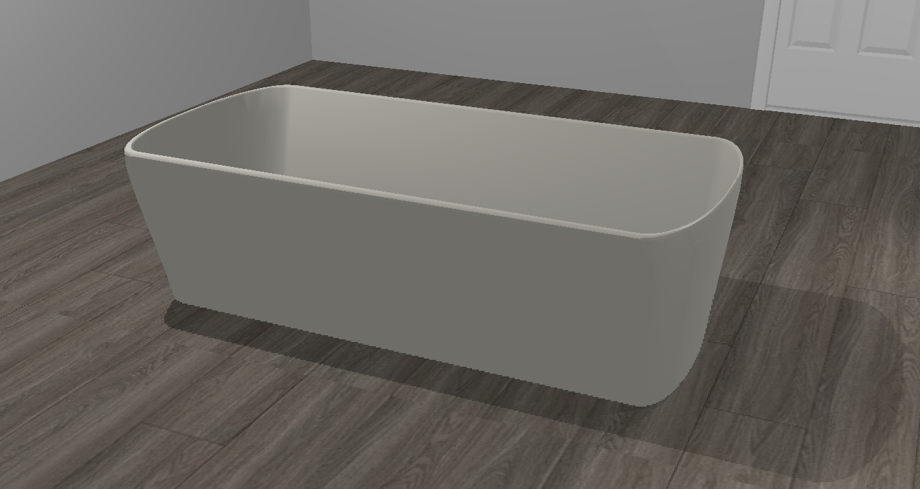

Ariana ThompsonParticipantHi Jonothan,
This drives me crazy too!
Here is a picture of my go-to “hack” in these situations: shown 60″x15″x30″
I like that generic “kinda modern/kinda traditional” shape, and if I need it to be a drop-in, I use countertop material to construct a deck. NOT ideal – but do-able in a pinch.
It’s actually the Baguette/Bread Tray from the cloud.
I make the little bread thing in it invisible, then change the dims to whatever. As with ALL items in the Cloud – after I recolour or resize it, I copy/paste the item then delete the original. Originals don’t like to SHOW the changes on the floorplan – but their copies will.
An *actual* mod-able tub would be crazy great – but I’ve made this work – for what it’s worth.
March 16, 2019 at 1:29 pm #229839
Jonothan Desimini
ParticipantAriana,
I appreciate your clever workaround for the tubs. Definitely one way to get around an issue that really shouldn’t exist on a program that’s specifically targeted at kitchen & bath designers. Regardless – things like this happen so thanks for sharing your fix, it looks great!
