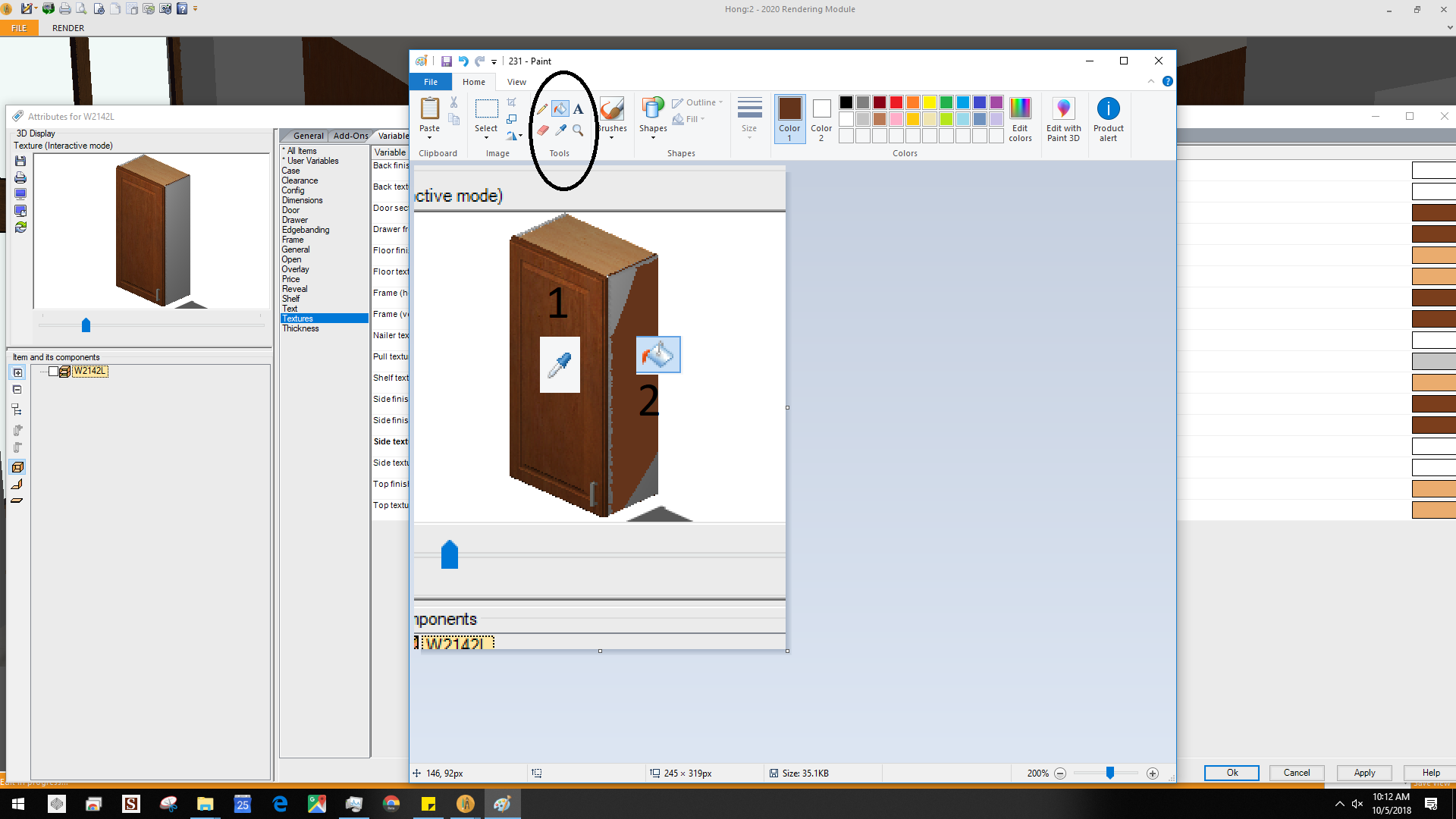

My suggestion is If we have tools like in the paint -copy texture -paste texture it will give us very fast solutions on the texture. I attached a picture that shows my wishes about this problem. If I have a texture copy tool first I click the texture which I want to copy than I click the fill texture tool which I can fill the side or top panels with the selected texture.

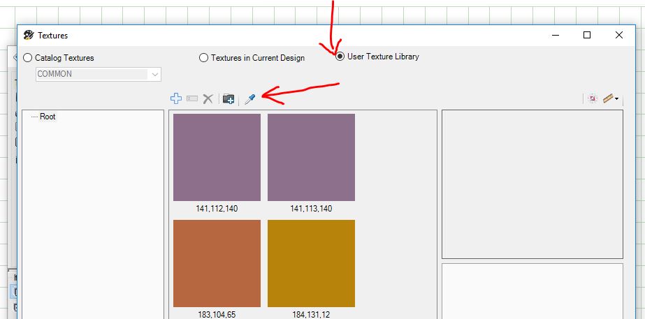

There is something very similar already in place in the User texture library. You can use the eye dropper in there and create any texture you put the dropper on and then you can apply that texture to any of the texture variables in the item.

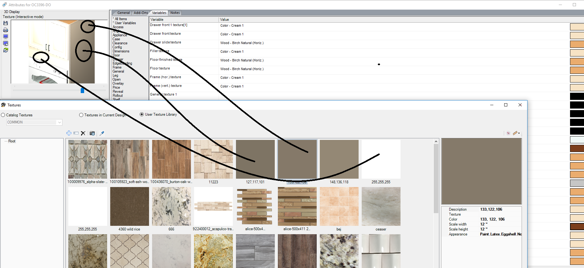

I tried that but that is not working properly. See attached picture. Wherever I click it gets the color that is perfect but because of lighting I got 3 different color with that tool and none of them is cream as you see on the other side texture as a cream-1.
I think 2020 needs to work on this tool.
I amazed how many colors I can get from the side of the cabinet because of the light shades.
