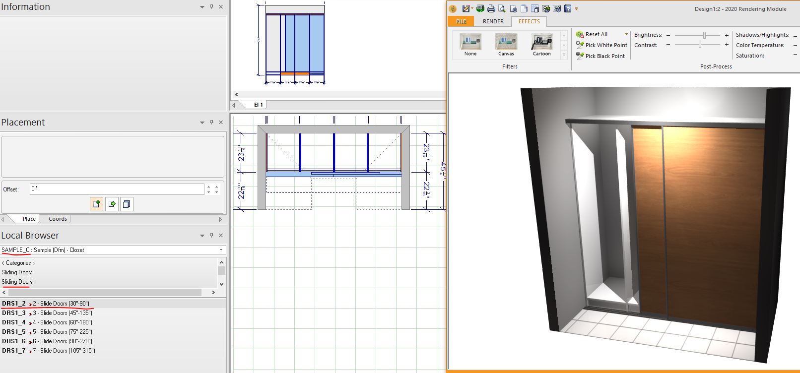

      Hello, i just downloaded 2020 flex demo for the closets and cant seem to find out how to make closets with sliding door, i did with single module division but not the holw module with sliding…
      is a must for me if anybody can help will apretiated. just need to know so i can upgrade to flex..

      I was not able to find a sliding door in the Flex catalog but I was able to find Sliding doors in the Sample_C catalog.
      The doors from Sample_C can be added to the whole closet panel run so even if you have 4 sections, the sliding door will cover them all. -See image below. I used the panel run from Flex and then added the Sliding door from the sample catalog to (hopefully) get the result you were looking for.
      Hope this helps out!
