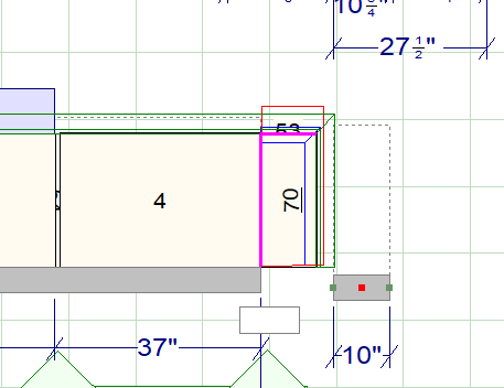

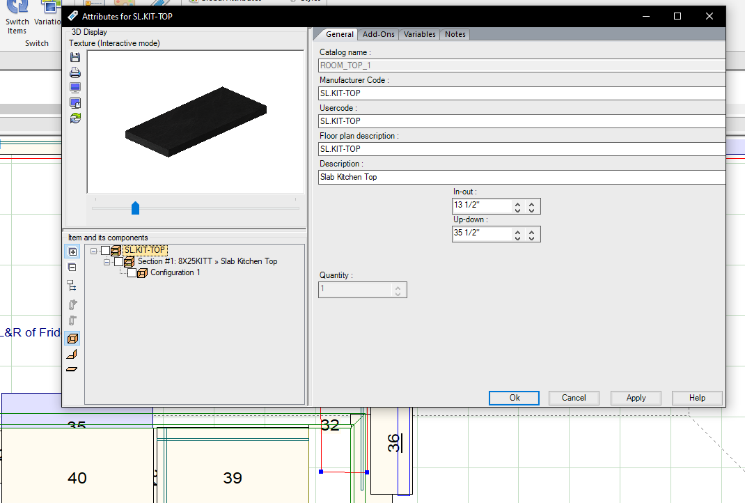

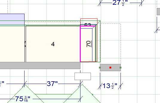

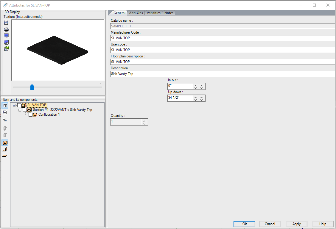

I get what you mean about what adding an opening means and have switched off collision lines before but in this case i’m faced with a new issue as I mentioned. When going in to adjust “in/out” in Attributes of the countertop, it pushes the CT further than inputting (see image). It jumps it a further 12″ or so.
countertop in/out setting is set to -5″ which should show the CT with 1/2″ past the wall but unfortunately isn’t the case.Attachments:

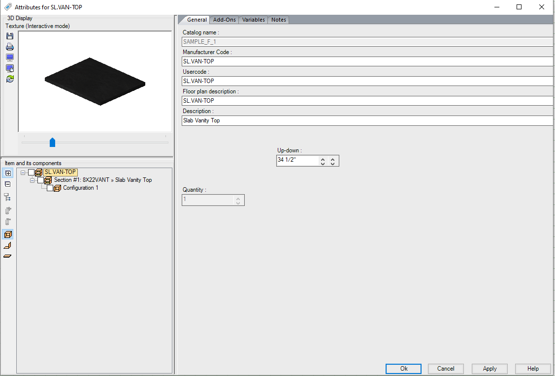

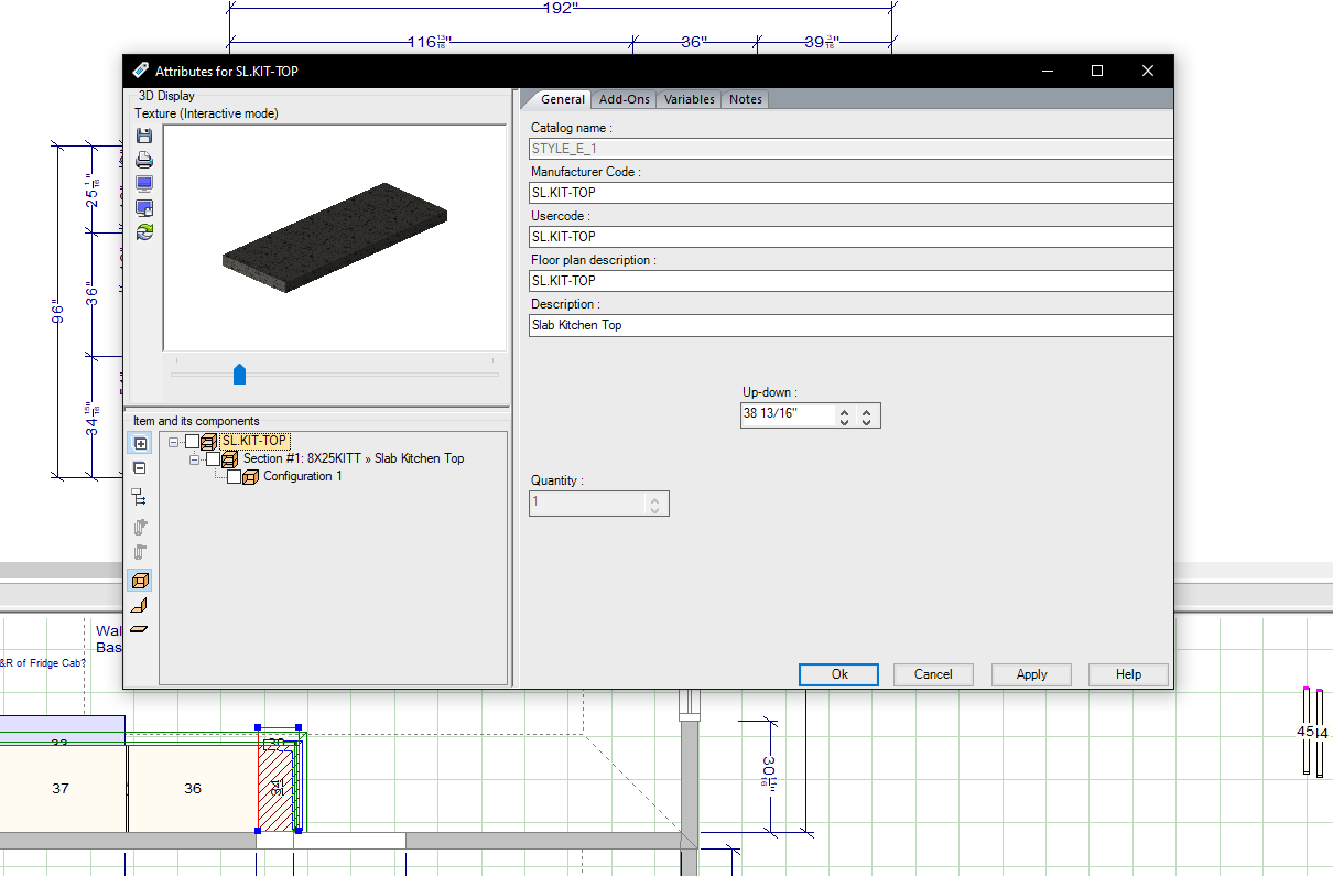

If you go into the Attributes of the Countertop, there is no option to change the In/Out. See images below. In the image you provided, we can see that the counter top (item that is highlighted) coming out of the wall. The only thing about the countertop in your image is it seems the line behind the wall is a little wonky.

Erik TornquistParticipantNo, only one counter. What you see is what happens when I change the in/out. I don’t know what you mean that the in/out can’t be changed when I’ve done it plenty of times and shows up here on this top (I pulled it far from the base temporarily while I try to figure all of this out).

Erik TornquistParticipantAlright, so I figured out how to fix this (i think) by creating 2 walls in that wall-opening at the counter space. We’ll see if this works. 1 wall from floor to 34″H, 2nd wall bottom @ 52″ up to ceiling, leaving that 18″ opening with room for the countertop to be mounted on the top of that first wall. Hopefully it works.
But there’s another issue that happens which I’ve experienced a few times before: You can see from the first pic the small wall is 10″ long, when clicking the green spot to stretch it out, it automatically jumps to 13.5″ and not giving me the ability to bring it back to say 12″; i have to go into the walls properties to input the 12″.

I believe we figured out whats going on here. The issue at hand is that you are only getting the option for the In/Out whenever you double click on the counter top from within the Placement Zone on the floor plan. IF you select the counter top (while in the placement zone) and right click on it to go to the attributes then the In/Out option will NOT be available to you. IF you double click on the counter top OUTSIDE the placement zone, there is no option for the In/Out. Currently, we are determining if this is a bug or if this is how the program was meant to be. Once we determine if this is a bug or not, I will post that information on this thread.
