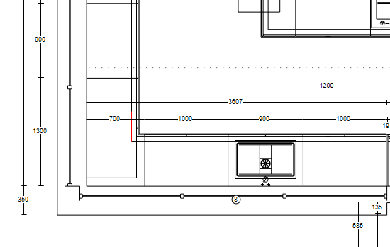

I have trouble identifying small objects when they are selected and highlighted in the software as I have deuteranomaly which is a from of red-green colour blindness.
Is there a way to change the white background to dark grey/black or change the colour of the highlighted object?
Any help is appreciated, thanks.
Picture 1 is how fusion currently is.

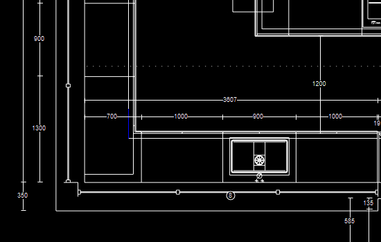

Picture 2 & 3 have been edited to make the object I selected easier to see.
