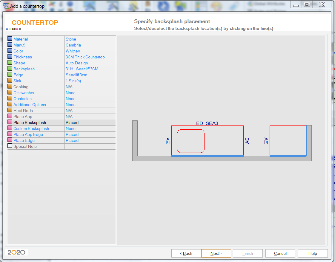

Having some challenges with v11.11.3.1 and Countertop Wizard.

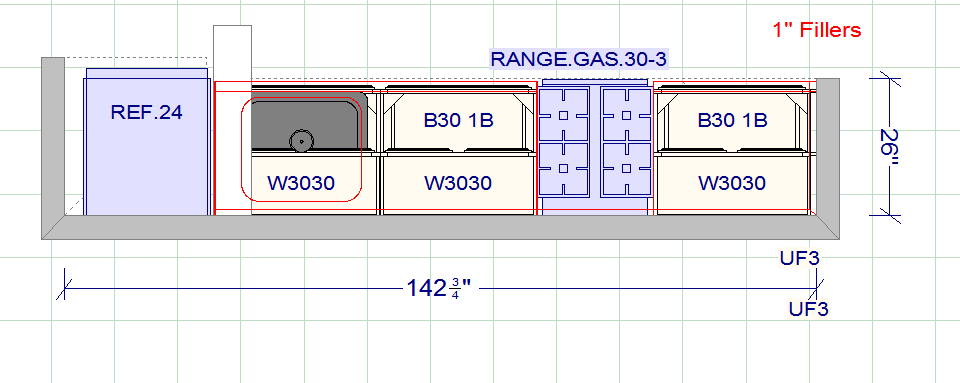

The program is drawing the backsplash continuous across the freestanding range and only shows up after “Finish”ing the Wizard.
Is anyone else experiencing this with the Cambria catalog?

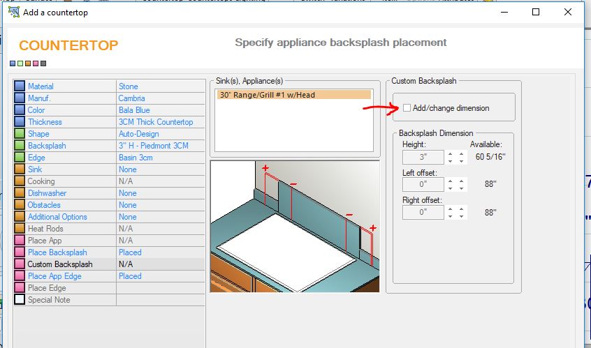

When you are placing the countertop using the wizard, when you get to the custom backsplash choice, remove the check from the add/change dimension checkbox and the wizard should not place backsplash through the range.

ParticipantNeil,
That is a work-around for now, but this seems to be happening regularly with my update to v11.11.3.1. Saw this happen very rarely with previous versions.
