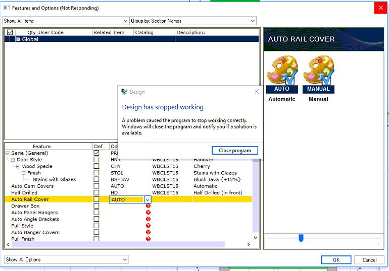

      Turning to the community as support has utterly failed me for the millionth time.
      Long story short, my issue has been going on for over a year and I’m about to lose it.  Support has submitted my issue as a bug, it has been escalated, personally I have spent 50+ hours trying trying to find a fix, replaced my computer three times (with brand new machines I might add) and the issue still persists.
      EVERY TIME I go into the feature sand options to set the options on ANY closet I design the program crashes.  It’s mind boggling.
      Does this happen to anyone else?  Is it the catalog that I’m using?  am I doing something wrong?  At this point all options are on the table.
      I attached a screenshot so you can see catalog and various options I selected on one of the recent closets.
      Can anybody please please help?
      Thank you,
      Ryan

      Here is the event log.  It is incredibly vague.  The only thing I have not eliminated as the problem is the catalog.
      Log Name:      Application
      Source:        Application Error
      Date:          11/8/2016 7:07:15 AM
      Event ID:      1000
      Task Category: (100)
      Level:         Error
      Keywords:      Classic
      User:          N/A
      Computer:      SEANH-PC.pwc.loc
      Description:
      Faulting application name: design.exe, version: 11.5.2.11, time stamp: 0x57d9b4c4
      Faulting module name: unknown, version: 0.0.0.0, time stamp: 0x00000000
      Exception code: 0xc0000005
      Fault offset: 0x2c72f070
      Faulting process id: 0x1378
      Faulting application start time: 0x01d239b882799cea
      Faulting application path: C:\Program Files (x86)\20-20 Technologies\Design\Bin\System\design.exe
      Faulting module path: unknown
      Report Id: 8a4171bb-fa38-4d1b-94b9-1d0ce9d0a8c5
      Faulting package full name:
      Faulting package-relative application ID:
      Event Xml:
      <Event xmlns=”https://schemas.microsoft.com/win/2004/08/events/event”&gt;
      <System>
      <Provider Name=”Application Error” />
      <EventID Qualifiers=”0″>1000</EventID>
      <Level>2</Level>
      <Task>100</Task>
      <Keywords>0x80000000000000</Keywords>
      <TimeCreated SystemTime=”2016-11-08T12:07:15.320580500Z” />
      <EventRecordID>5652</EventRecordID>
      <Channel>Application</Channel>
      <Computer>SEANH-PC.pwc.loc</Computer>
      <Security />
      </System>
      <EventData>
      <Data>design.exe</Data>
      <Data>11.5.2.11</Data>
      <Data>57d9b4c4</Data>
      <Data>unknown</Data>
      <Data>0.0.0.0</Data>
      <Data>00000000</Data>
      <Data>c0000005</Data>
      <Data>2c72f070</Data>
      <Data>1378</Data>
      <Data>01d239b882799cea</Data>
      <Data>C:\Program Files (x86)\20-20 Technologies\Design\Bin\System\design.exe</Data>
      <Data>8a4171bb-fa38-4d1b-94b9-1d0ce9d0a8c5</Data>
      <Data>
      </Data>
      <Data>
      </Data>
      </EventData>
      </Event>
