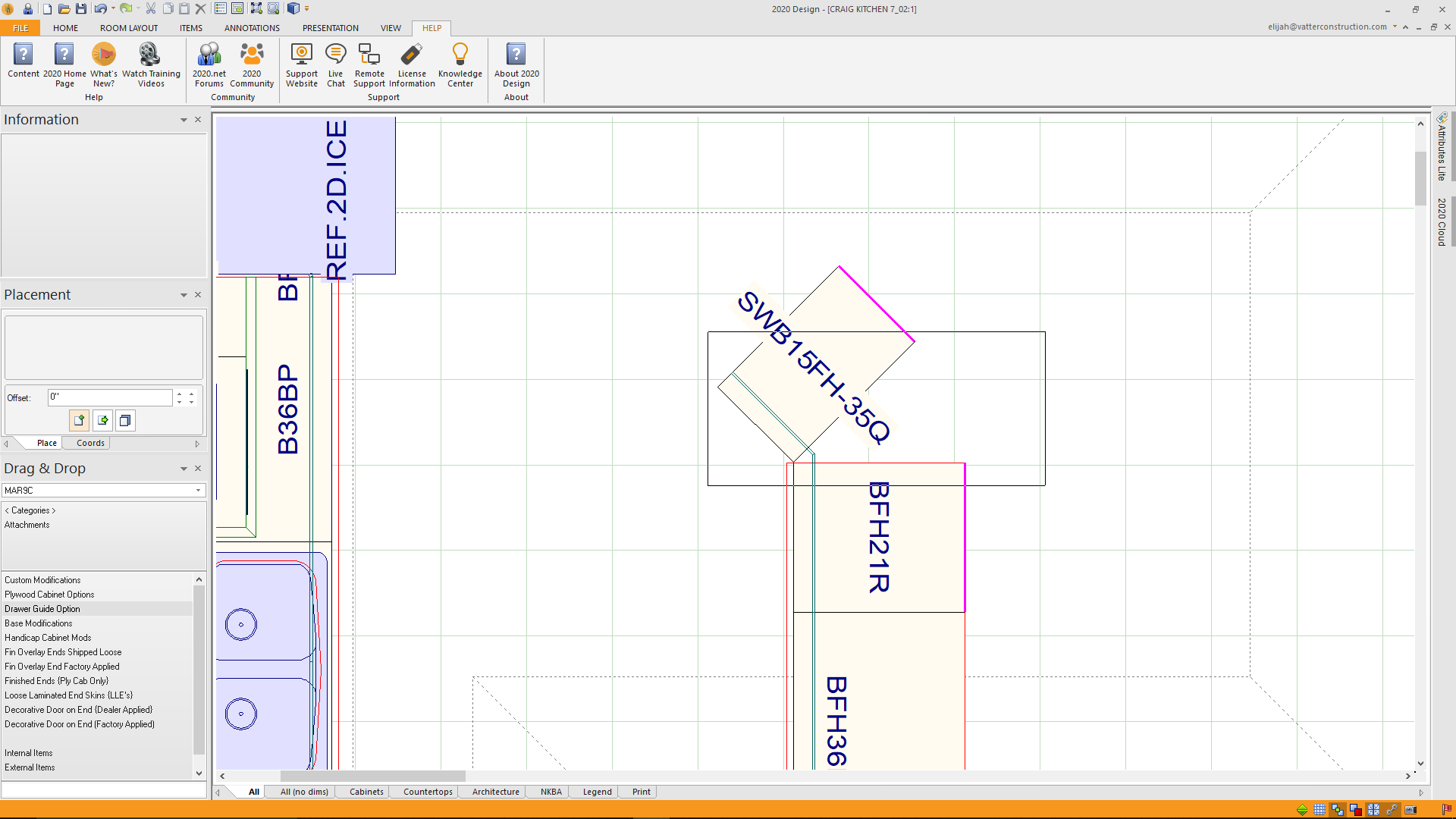

Hi all, I am attempting to create an angled peninsula for a kitchen design I’m working on but I can’t seem to figure out how to fill in the space outlined by the black box in my picture :/

Some catalogues have cabinets that are 135 angle (sometimes even variable). If your catalogue doesn’t have this, you may have to see if you can get it added.
The one on the left is our default one and the one on the right has had one of the Widths adjusted. I have yet to find out if I can get rid of only 1 of the handles and to choose which one.

I too deal with a cabinet company that doesn’t have a lot of more unusual shapes. My go-to is to order some finishing panels, and a couple of 2″ thick shelves, and have the install create open shelving odd places.
