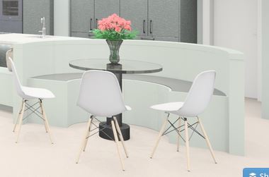

ModeratorHi Richie,
You can use *box and curve it using the edit graphic fixtures tool. You can also use a curved wall within the Advanced Graphics Catalogue.

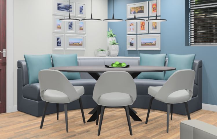

ParticipantCurved seating booths are a doddle to do. Well they where before the upgrade, as the upgrade removed the sofas from advanced graphics. With *sofa you could make anything with it. The image attached is entirely from *sofa. By making a template to the shape/size/parameters you can rotate each segment of *sofa to form a curve by making each segment of the curve 100mm & then rotate it 2/3/5 degrees to suit the shape required. Using *box doesn’t give you the soft shapes. Half the skill in using fusion is in knowing how to make things from scratch. Whats required is than when upgrades happen they don’t bin the components with which to create. Flooding the cloud with one size fits all designs/ items just produces identikit visuals & removes a valuable skillset. Thankfully the grouped units feature allowed me to save vast swathes of components that where in the advanced graphics catalogue before they got the axe.

ParticipantHere is what you can do achieve with *sofa. The table acts as a template & by making the sofa about 650mm deep 875mm high & 100mm long you get the ends & middle in place at the lengths you require for your particular sceheme & you rotate freehand or move by 2/3/5 degrees the item. Attach the cursor to the the last segment , duplicate the segment & keep moving it into place

David Boon
ParticipantThis is what the finished article looks like. Components to make things are the life blood of the Fusion system. Creating bespoke solutions requires the CAD system to be able to execute it to create a truly unique look. The pendant lights above the table are a mix *cylinder , *cone & spotlights. If you look on my renders on the inspiration contest gallery you will see that they use very little standard parts/ items. The Eggersmann tall unts have to be made from tcarc/ a door front because the catalogues don’t have the seamless doors. *box to make the tall vertical recess handle, Air Uno ceiling extractors made form *box,*ceiling wedge, & other non standard items. Miele mastercool fridges from tcarc, door fronts & matching Miele handles form the the non standard Miele catalogues. Scratch building is in the main still very much required.
