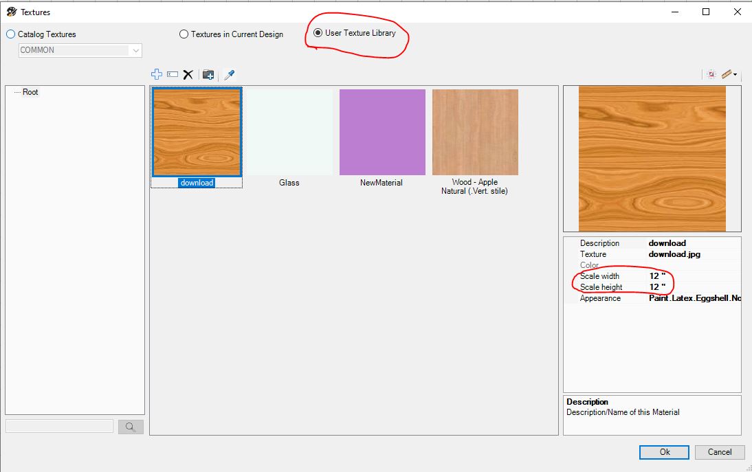

I also have tried adding slabs but the outcome is a shrunken slab photo shown as a repeating pattern. Any tips?

If the slab texture you’ve added to the program is to small, then you can increase its ‘scale height’. See the attached image.
May 8, 2021 at 12:19 pm #329172Katya GarciaParticipant
That worked perfectly. Thank you!!
