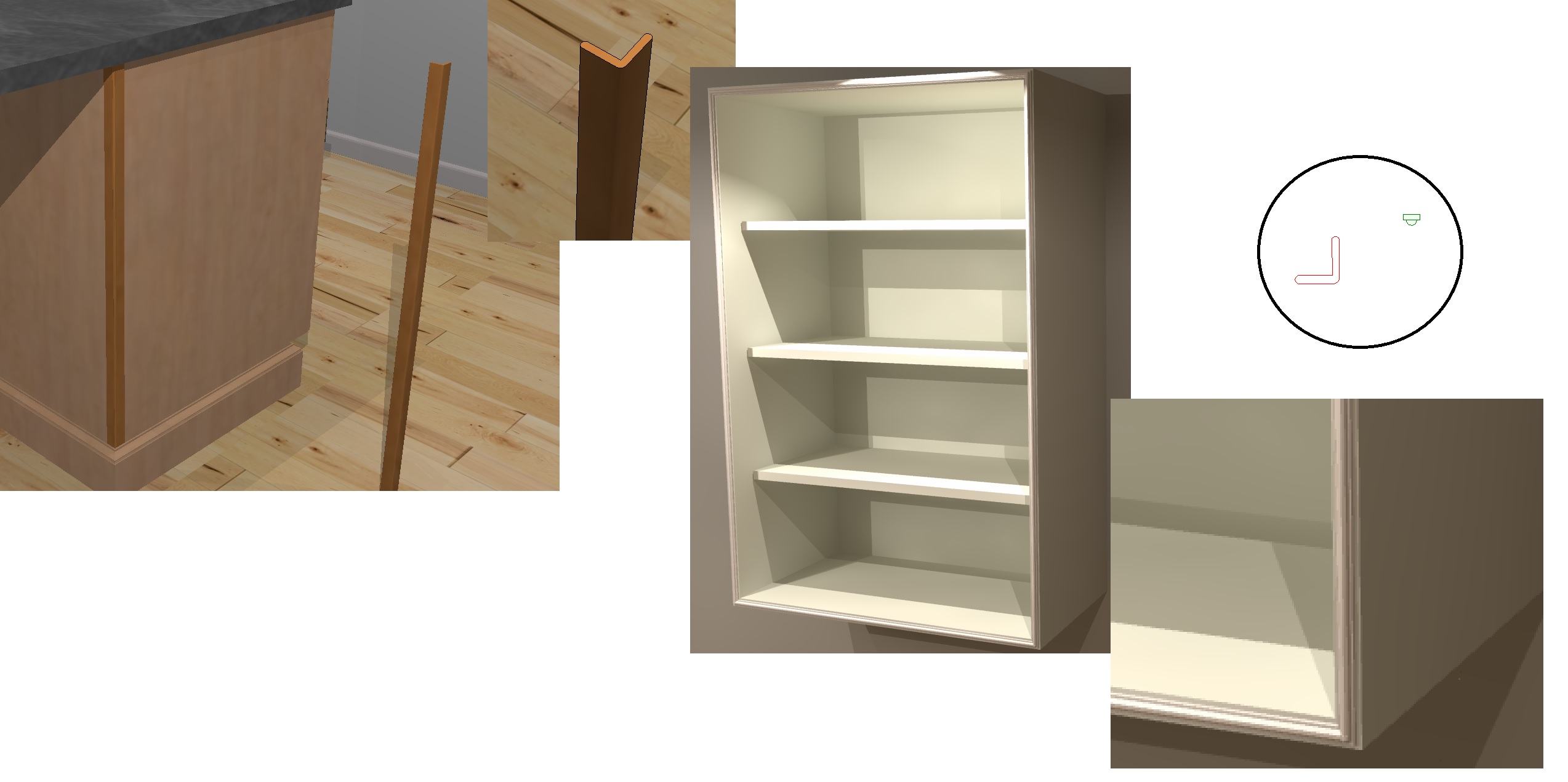

May 18, 2019 at 6:58 pm #238725
ParticipantI use countertop to create corner molding (I just save it in a kit file for Accessories). I use a combo of the Shapes Cube and Shapes Cylinder to create molding for around a cabinet for example.
Here’s a pic.
May 21, 2019 at 11:43 am #238910
Kenny Hall
ParticipantThanks Ariana, I’ll have to give that a try!
