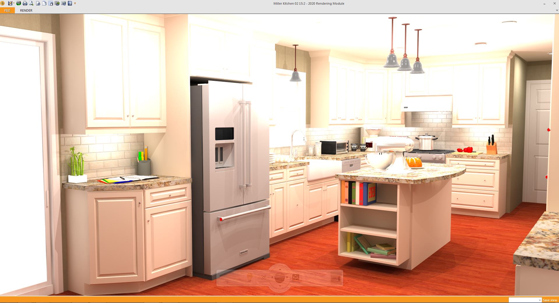

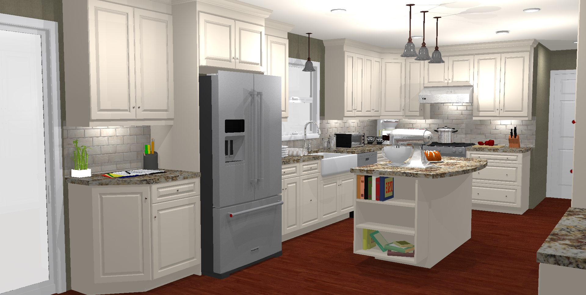

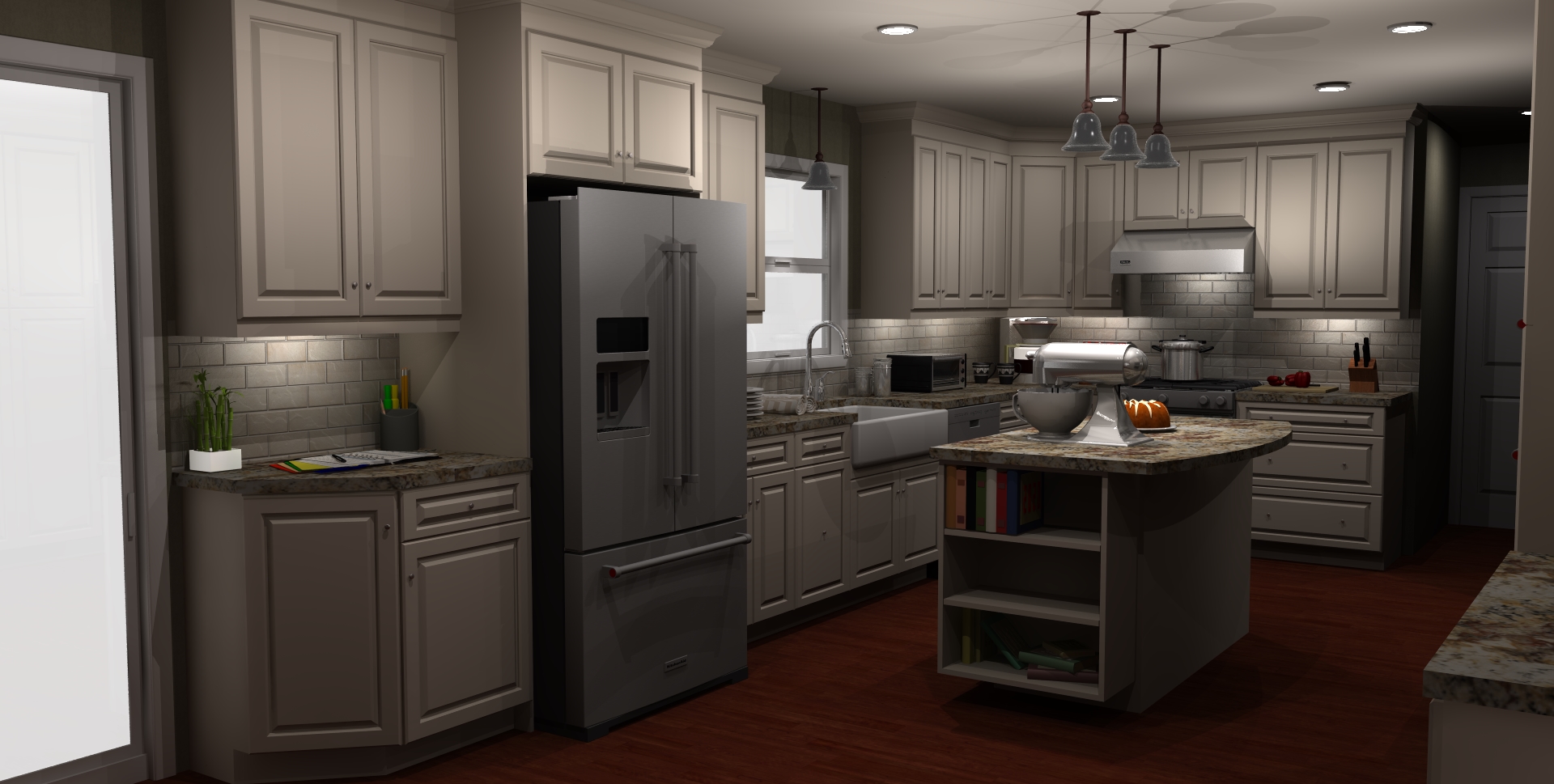

      I’ve included three pictures. One is a screenshot of the rendering screen(Before), one is doing a regular quick render(Miller Kitchen), and the last is doing the best render(Rendering). So confused!
