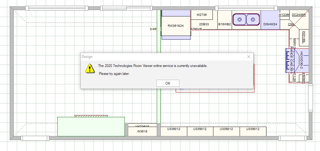

I am using version 11.2 and I like using Room Viewer for my customers instead of the 360 Panoramic View. Tried to use it today and it says it’s offline. Is that permanent or temporary? Thanks!!

Room Viewer is up and running. Two things you need to make sure of.
First, when you are trying to open the room viewer do it from the email, not the link that pops up in the software. That link often arrives before the server is ready to show the image where as the link in the email is sent once the server is ready to go.
Second, you need to use Internet Explorer running in compatibility mode to view anything from room viewer. If your default browser is anything but IE you will need to open IE and copy the hyperlink into the address bar to view the image.
On a final note, Room viewer’s days are definitely numbered. We are removing it from the software with the release of version 12.
Thank you

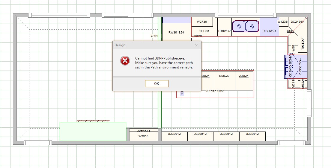

Hi Neil,
Thanks for that info! I don’t have a problem opening it, but a problem with getting it to run in the first place. Please look at the attached photos of the errors I’m getting.

Hmmm, I don’t think the service is the problem. It seems you are missing a file on your computer. Re-installing the software will probably resolve the issue.
You might want to look into your antivirus just make sure it is not quarantining files from 2020. White listing 2020 or setting an exception in the antivirus will usually stop that from happening.

I reinstalled 2020 and still no luck. Not sure why it’s not working for me. I searched for the file in my folders and it’s there.

Hey Jordyn,
That’s really odd. 2 more things you can try.
Go into the maintenance tools and run repair com.
Run 2020 “As Administator”
If neither of those work give us a call at 1-866-697-2020 and we can look into it in more detail.

Okay, I got it to work on some designs, but others still aren’t cooperating. Maybe the design file is corrupted?

It’s possible. You can try doing a copy/paste of the design to a new file and see if that resolves it.

Did that, didn’t resolve it. I think it has something to do with the cabinet catalog. I started deleting different elements of the design to troubleshoot and when I deleted all of the cabinets, it worked. As soon as I added them back in, it didn’t. Not sure how to fix that 🙁

Which catalog?
August 12, 2019 at 5:59 pm #245870Jordyn PennyfeatherParticipant
Wellborn Premier – WPRE190A

Hey Jordyn,
At this point I think the best thing to do would be to give the 1-866-697-2020 support line a call. We can get a copy of the catalog from you, check the error logs and see what we can see with the design itself.
