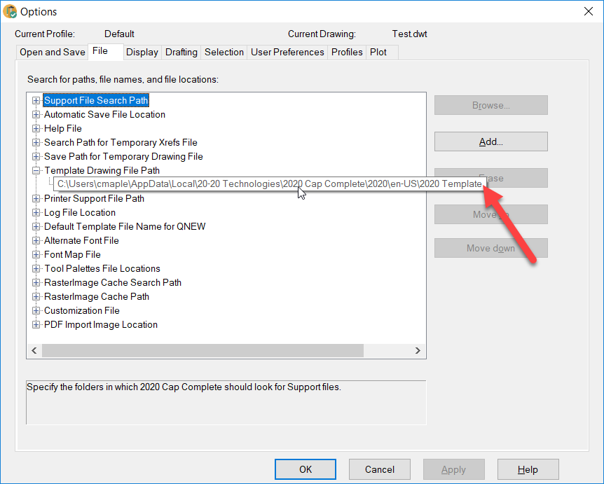

      This is an issue in the pilot. It will be fixed in the official release in November BUT there is thankfully a work-around.
      1. Go into Options
      2. Click the File tab
      3. Go to Template Drawing File Path
      4. Remove the last “\”
      5. Apply
      Your templates should save correctly and you will be able to find them when you set the default.
      I have attached a screen shot as well.
      Sorry for the inconvenience,
      Ciudy
