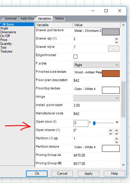

September 18, 2018 at 10:02 am #204033
Neil WilsonParticipantKarlie,
in the cabinet’s attributes\variables there should be a setting, usually a slider, that lets you open doors/drawers.

Karlie Rouzer
Participantnevermind, i figured it out! Too bad you cant do that with every catalog!

Neil WilsonParticipantHey Mike,
My catalog does not include that path…. I can search for and find the BNC2N100 but I can’t open the drawers. It seems the shape won’t allow it. It’s how the cabinet is coded and it would be up to BLUM to request the change.
