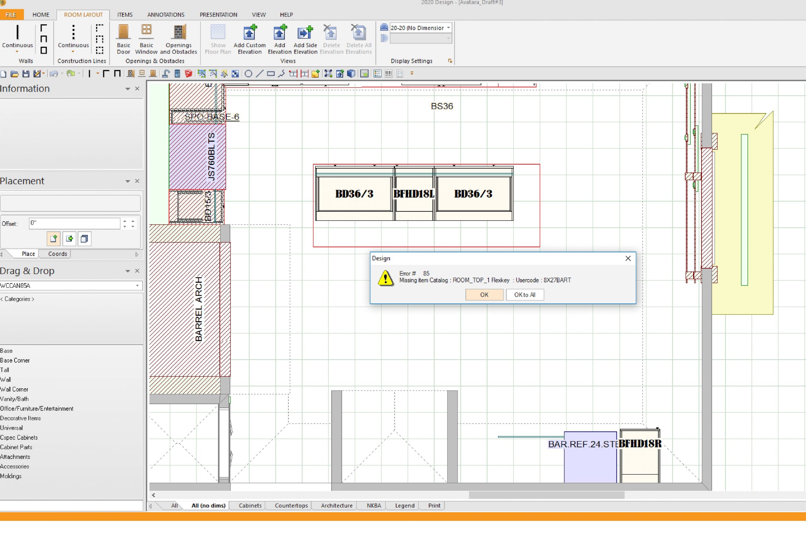

Anyone know what this error means?
I tried Copy/pasting the entire design into a new kit file – the error followed me!

ParticipantLooks like the program can’t find the item marked 8X27BART (8 x 27″ Bar Top) in the ROOM_TOP catalog. Could be a corrupted ROOM_TOP catalog or could be a corrupted item in the file. First things I would try are:
Delete all the tops and see if that eliminates the problem.
Alternately, I would use the switch items tab, select the ROOM_TOP catalog and if there were any items listed there as 8X27BART delete them.
Then I would save, close, and reopen the file, make sure the error was gone and then redo the countertops.

ParticipantWell, whadda you know. I just got a similar message when I saved an edit on my countertops. Same basic message but different item #. I just clicked on OK. the message went away and no further issues.

Yes – I okayed the error the first time – and thought that was that – then it started to flag me everytime I opened the file – and I don’t know enough about computer stuff to know if this is one of those “growing” errors that gets worse and worse until you can’t open your design anymore!
I will delete all the countertops, save, close and reopen as you suggest!
