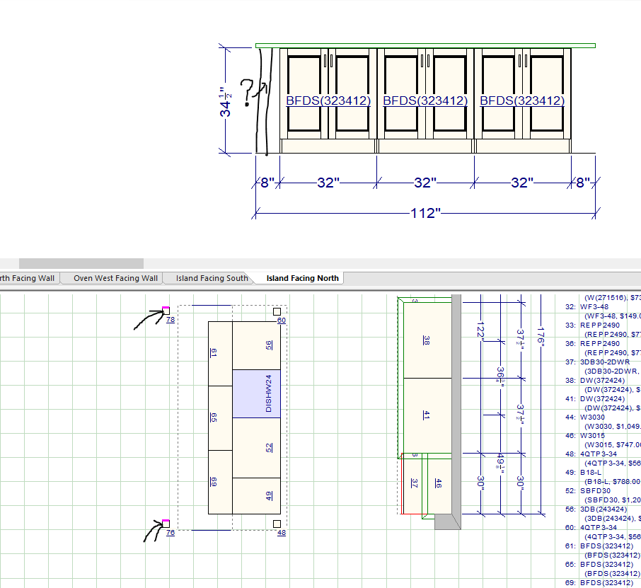

So I have an object (posts for an island) that I want to include in the elevation. Is there a way to extend the placement zone or selectively insert objects from the floor plan into any elevation? See image attached to see what I’m talking about.

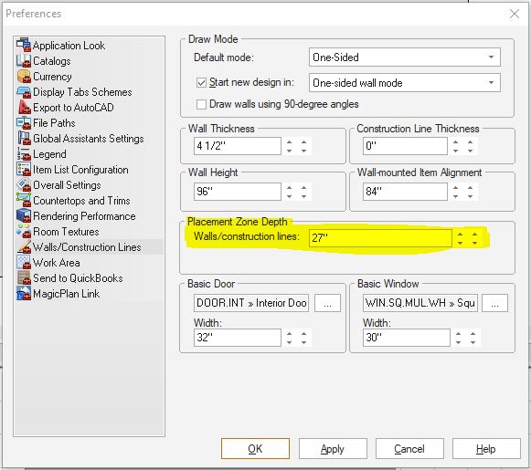

In the preferences under walls/construction lines there is a preference for depth of the placement zones. You should be able to extend the zone enough to get it to include the post.
