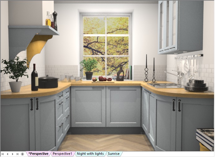

The tab views make it really easy to switch between different versions of the plan, to the point that now I keep everything turned on in the original plan (the one that gives layer and lighting settings to all shared views. I have a ‘working’ tab which I turn on only what I need at the time and put notes that are only meant for me. Then when it’s time to present I make a client annotation view and for fitting the same.
Can do this on elevations if you need too!

ParticipantPlaying around with the named view tabs in Perspective, and it appears to ignore the fact that I’ve hidden layers when I’ve assigned a tab to a view. – So I have my view of a sink wall, but the island is in the way, so I’ve assigned the Island to a layer, and hidden it. I’ve now gone to my main view, where I want everything to be visible, and un-hidden the island layer, then given that view its own named tab also. However, now when I go back to the other tab views, the island is visible in them all….
September 27, 2018 at 4:36 am #205692
Grant Hughes
Participantassuming this is v6 now:
on the tabs where you want to hide layers have you right clicked on the name and un-ticked the “layer settings shared with main view”
It’s on by default and if you make a change to any ‘pink’ view (it turns blue once this option is off) it automatically changes in all other pink views.
Same thing can be done for the lighting
