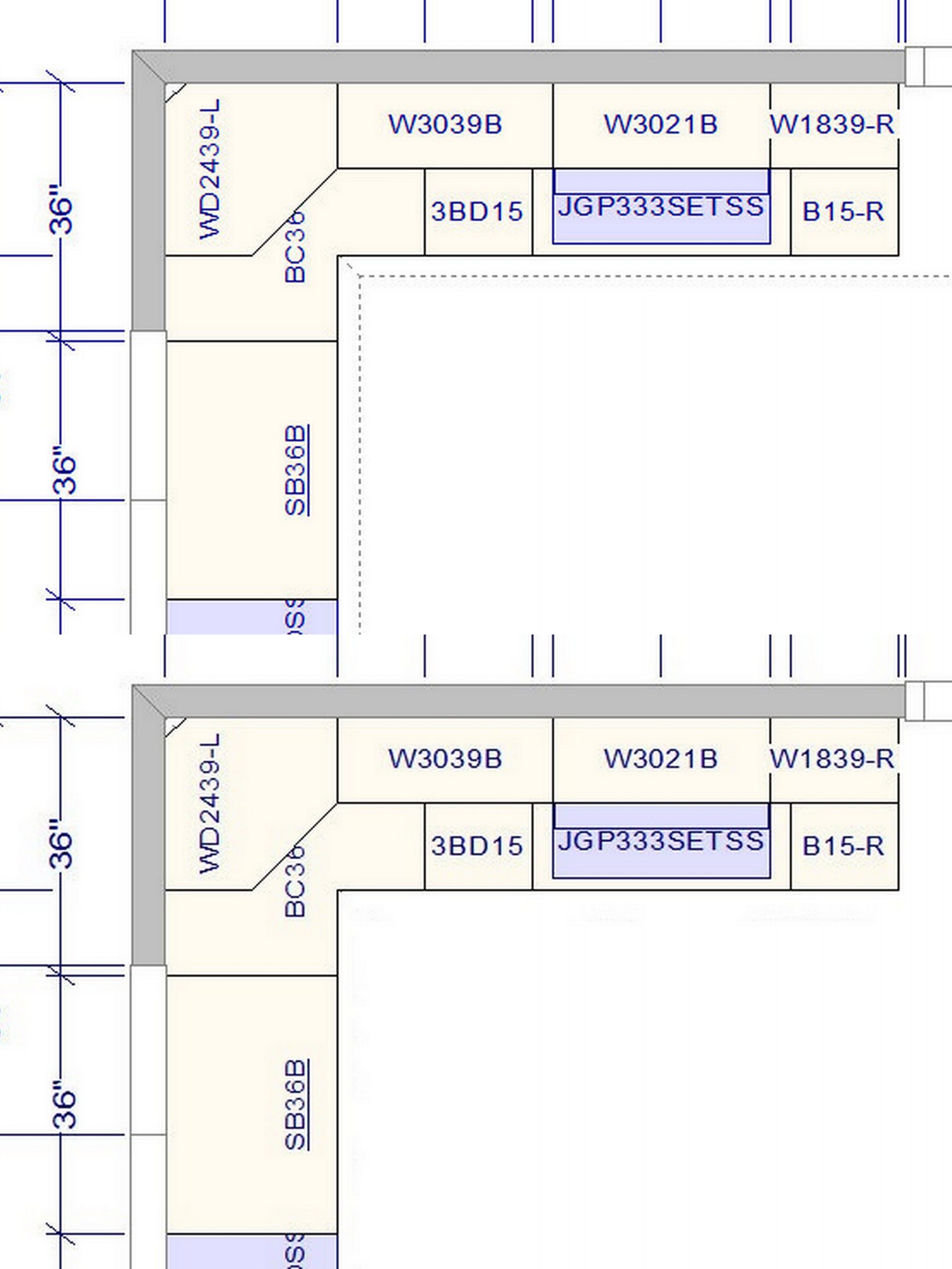

      Years ago (15 plus), when you printed a floor plan the placement zone went away, much like the grid does not print.   Is there a way to have the placement zone not print on floor plans?

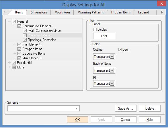

      Placement Zone: Right Click in the drawing area, Display Settings, Items. Expand General Settings, expand Construction Elements, click on ‘Placement Zone’ and then change Outline to ‘Transparent’, Save As whatever scheme you are using – usually ’20-20 (All Items).shf     NOTE. If you untick placement zone, you lose the measurements so we just change the colour of the dotted line to transparent.

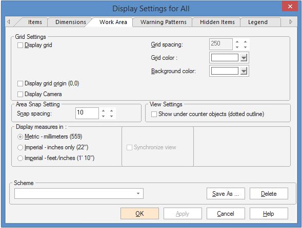

      Grid: Right Click in the drawing area, Display Settings, Work Area, untick ‘Display Grid’ – the one at the top left of the box. Save As whatever scheme you are using – usually ’20-20 (All Items).shf

      That removes it while working on the plan, correct?  I want it to disappear for printing, the same way the grid lines disappear.  It used to do it way back with version 5 or 6 and then it changed. There is no need for it on the printed version. It’s there to show where you can place and for selecting a placement zone.  Makes it confusing for the customer/installer on the printed floor plan.</p>
