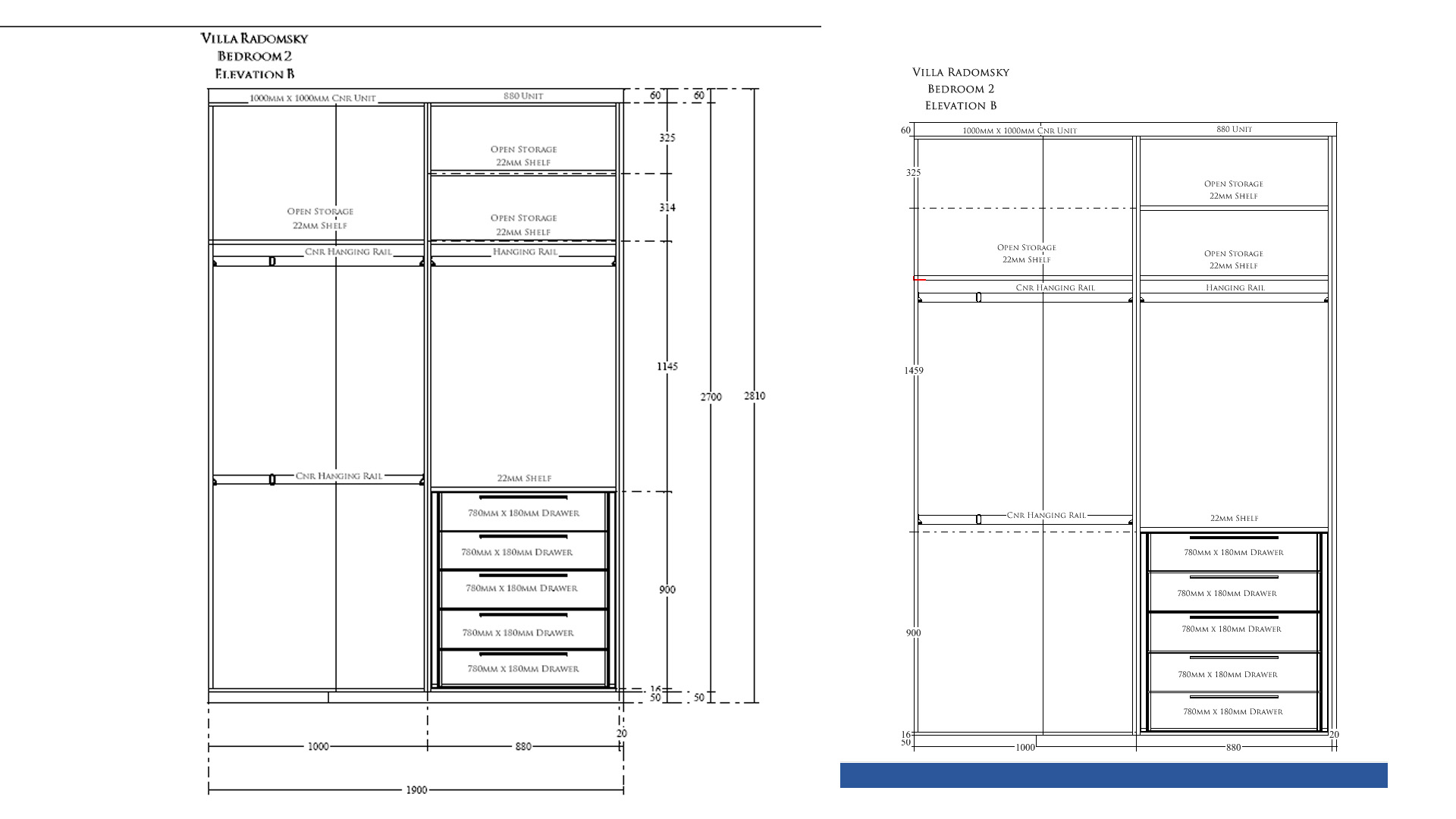

      I have noticed that the issue has been resolved in V5.3. However I now find that I am unable to Shift select multiple dimensions. The only way to select multiple dimension is to draw a marquee select around them all.
      I am also finding that if I manually dimension a drawing or use the dimension multipoint tool, when I close and then reopen a design the dimensions are repositioned in random areas of the design. This becomes quite bothersome as I need to then reposition all the dimension. Attached is a screen shot comparison of what I saved, and what I get when reopening a design.
      Otherwise I really think that you guys are heading in the right direction with dimensions and annotations, now just need the option to align and distribute manual annotations evenly within a design 😉

      Thank you for your post, we are addressing the issue where you are unable to hold shift and select multiple dimensions. I will keep you updated.
      In regards to your manual Dimensions changing to random positions when closing and reopening a design – I would like to connect and take a look as I am having trouble reproducing this one. Please can you contact me on either of the below details so we can arrange a remote session?
