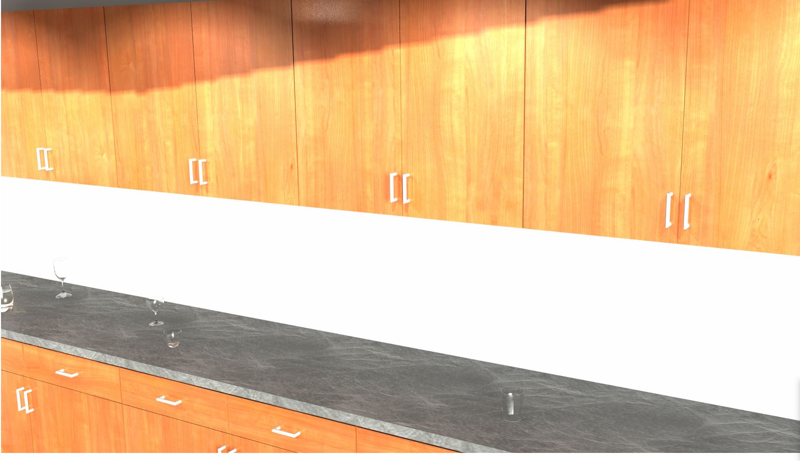

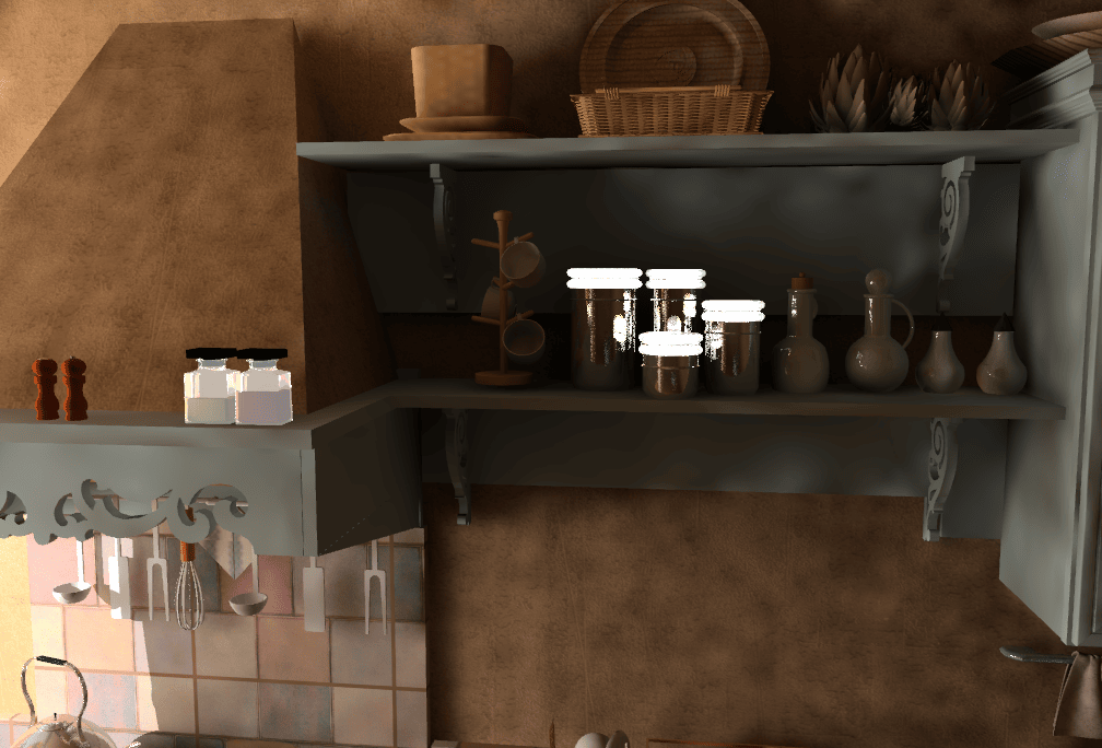

      Every time I render a design, any objects that are made of transparent glass or plastic start “glowing” bright white right as the render finishes up. (see attachments for examples) I’ve tried just about every glass and plastic texture, as well as adjusting various combinations of light levels (ambient light, exposure, moving light sources, etc) but that does not seem to make it go away. The only thing that makes the glass not light up is turning off global illumination, so it may be some kind of raytracing issue, but then of course without global illumination that means nothing is rendered nicely and it just looks the same as the realtime view.
      Am I just missing a specific combination of settings, or is this a soft/hardware glitch?

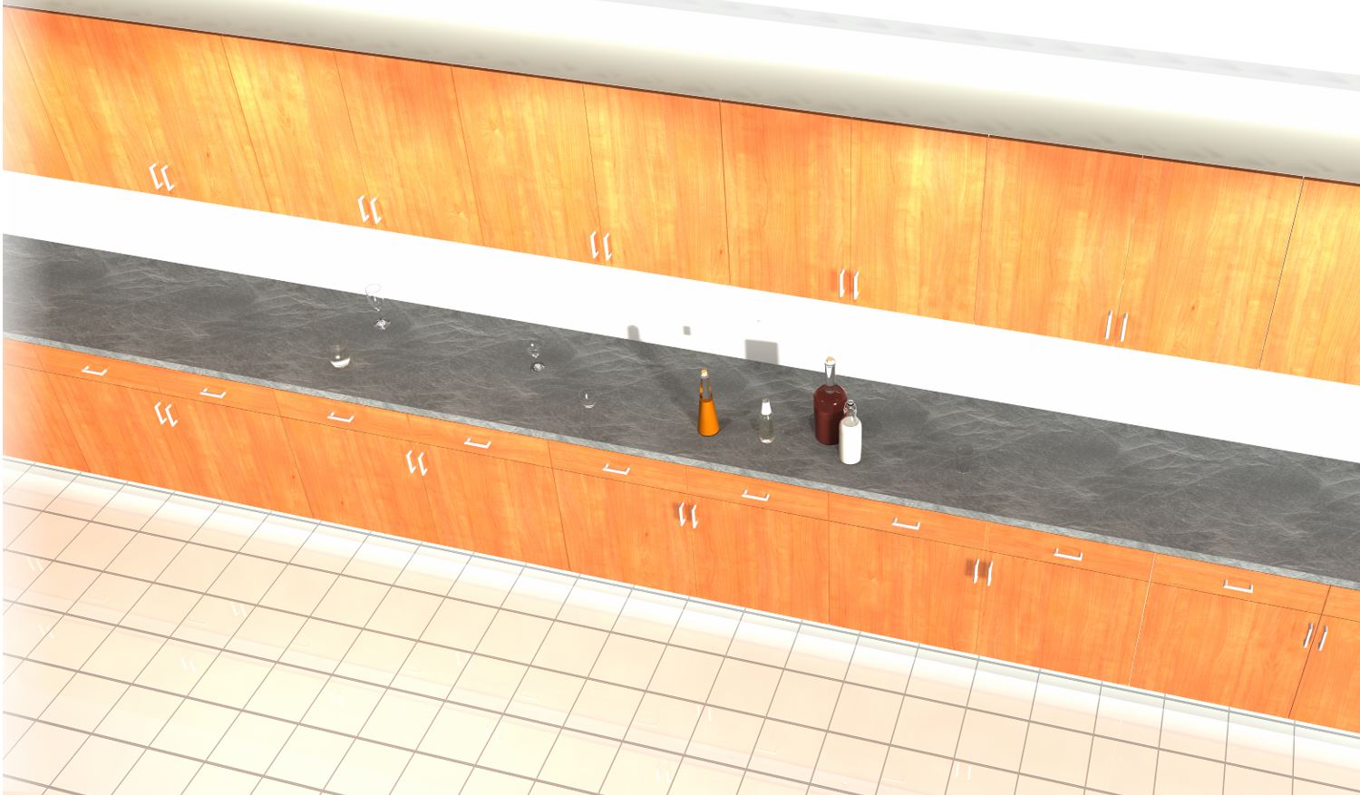

      I went ahead and tested the above in my version 13.2 using RedWay 3D and it worked correctly. I took some bottles and cups from the cloud – made sure they were set either to a glass or a plastic texture and then created a high quality render and the glass seems to be fine. -See attached images.
      Which version of the program might you be using currently? Are those items from the cloud or taken by SketchUp? If possible, would you be able to send your design file to ResidentialSupport@2020spaces.com. It is also possible this could be an issue with your graphic driver so I would also suggest to update your graphics card. If anything, I would suggest to contact our support department so we may take a closer look at the issue. You can contact us by calling 1.866.697.2020.

        Thanks for your reply Kris! I am using version 10.7.3.35. I’m aware this is a much older version, but it’s the only one I have access to since I am a kitchen designer at Home Depot and do not have control over what software we can use. As far as I know, all of the objects I have are what comes preloaded with the software.
        Also, is there anything specific I should put in the subject line or email body when I send the design file to support to make it easier to help?
        Thanks again!
