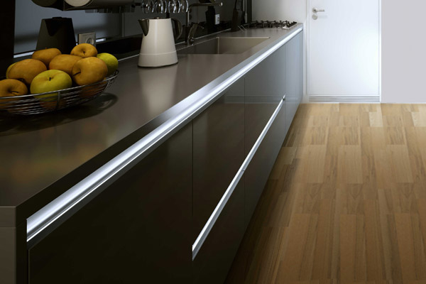

Lukas -> www.szymtech.plParticipantHi Dan
What catalogues You have now?
What do You mean by rail system? Like this in attached photo? There is an alu bar cutted into base caracase.

ParticipantHi
Yes that’s the system. I’ve got crown imperial and just discovered that their Rialto range can be handless so think I have solved it now.
Thank you.
