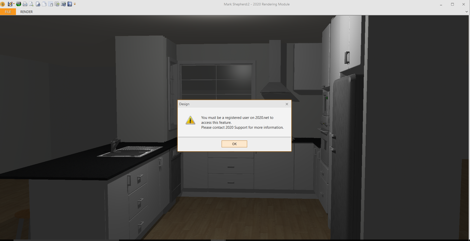

      I work for a Kitchen designing company in Australia and it is quite hard to get in touch with support team as there is none here πŸ™
      Recently I am trying to use the 360 panorama feature to wow my clients but I am having issues using it. I have registered at 2020.net and yet every time I click on 360 Panorama button, it says ” YOU NEED TO BE A REGISTERED USER AT 2020.NET TO BE ABLE TO USE THIS FEATURE. CONTACT 2020 support team”. I did contact 2020 support team but haven’t heard back from them πŸ™ Is there anybody out there who can help me out? Will highly appreciate it!
      Elham ( From the down under!)
    • January 5, 2017 at 9:33 am #116449
      Edith
      Hello Elham
      Most probably some data is still missing in the registration.
      Can you please send me your license number at the following address so I can verify: residentialsupport@2020spaces.com

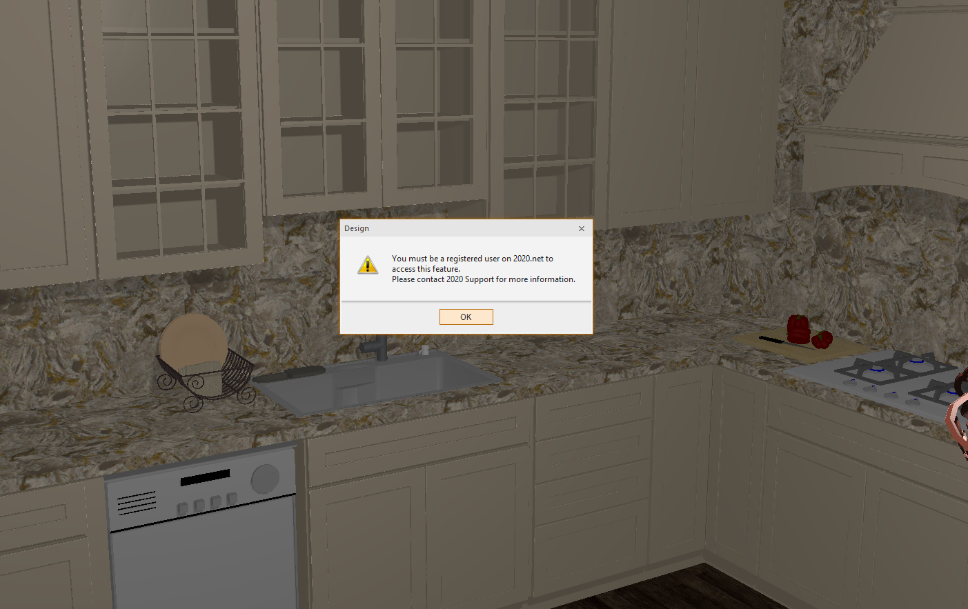

      I am having the same error message when I click on 360 panoramic view. Could you please help me, thanks.
    • October 11, 2017 at 9:14 pm #153535
      You need to be registered on 2020.net as well as 2020spaces – 2020spaces is for the forum and cloud, 2020.net is what enables the Panoramic feature (afaik).
      The Panoramic feature is reliant on being able to validate your license key and when you register on 2020.net, this is one of the questions asked.
      https://www.2020.net/Register.aspx
      Registration seems to be manually approved and takes 1 working day in my experience (I support 30+ users).
    • October 12, 2017 at 7:52 am #153544
      Ugur Oozturk
      Hello Mike,
      I have tried registering but it said tht I am already registered. I can sign in to 2020 net and spacases and cloud on the application it self. but then when I click on 360 rendering it still gives me the same error
    • October 12, 2017 at 7:49 pm #153717
      Hi Ugur,
      Then I think the only thing is to ask support to sort it out – email all your details including key number to ResidentialSupport@2020spaces.com
      Cheers
