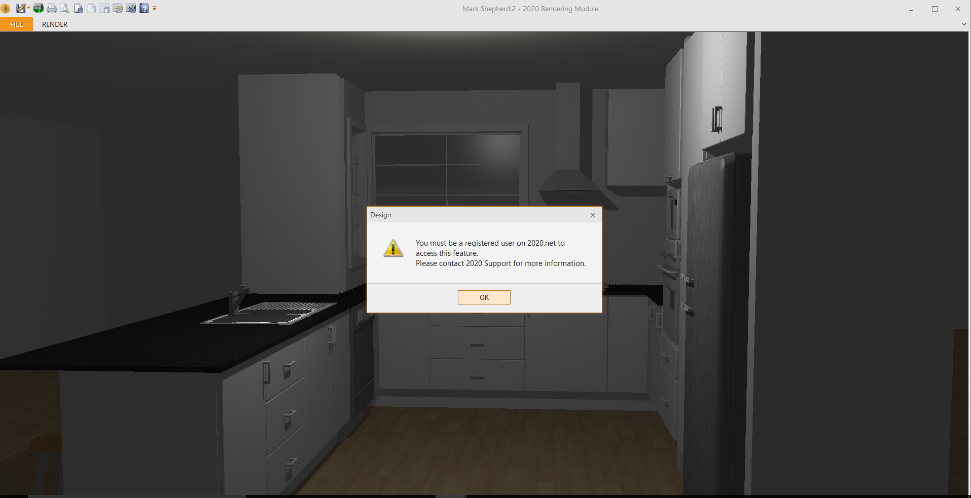

      I work for a Kitchen designing company in Australia and it is quite hard to get in touch with support team as there is none here πŸ™
      Recently I am trying to use the 360 panorama feature to wow my clients but I am having issues using it. I have registered at 2020.net and yet every time I click on 360 Panorama button, it says ” YOU NEED TO BE A REGISTERED USER AT 2020.NET TO BE ABLE TO USE THIS FEATURE. CONTACT 2020 support team”. I did contact 2020 support team but haven’t heard back from them πŸ™ Is there anybody out there who can help me out? Will highly appreciate it!
      Elham ( From the do under!)
    • January 10, 2017 at 5:00 pm #116895
      Hey Elham,
      Go to 2020.net and then go into to your profile and set your country to United States and see if that resolves the issue. Β Also make sure that every thing is set, no blanks in time zone for example.

      ELHAM YOUNUS
      Thank you! Got it sorted πŸ™‚ I wish there was more support available for Australia!
    • February 16, 2017 at 1:17 am #120174
      ELHAM YOUNUS
      I actually had troubles with the registration. It seems the registration wasn’t linked to my 2020 product key. A support member helped me out by registering again in 2020 and that sorted the issue out. I wish there was a support contact number for Australia!
