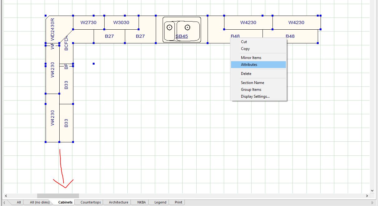

I’ve been testing the catalogs and seeing how it works and from what I’ve seen, it looks like there is a refreshing issue with it. Once you’ve applied the handles to your drawing, save and close the file and then reopen it. This should refresh it causing the handles to appear in the render!
A quick way to apply the handles to the drawing:
1. Once you have the drawing and you are ready to apply the handles, switch to the Cabinets tab and lasso the drawing to select everything.
2. Right click on everything you have selected and go to Attributes.
3. Click on Add-Ons, then locate the Hickory catalog and add a checkmark to the Hickory Hardware Pulls.
4. Once you do that, you can go to ‘Styles & Pricing’ to add a style to the handles.
5. Save the drawing, close it and reopen it.. you should now see your hardware!
