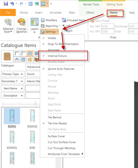

ParticipantHi, when i am taking views of my designs i used to be able to step outside the room and click the button to hide the walls. all was working fine until the last update. now when you step outside the room the wall and windows disappear but the doors stay visible. it used to make them invisible automatically but now you have to highlight the door and make sure its invisible.
is this a bug or is this what i have to do now?

In Fusion 85.0.92 there has been enhancement’s to the hide wall feature. Internal doors, window and walls no longer autohide
You will be able to select the door and disable the internal fixture flag. See attached screenshot.
Also if you add a exterior door instead of a interior door, the exterior door will hide automatically. Exterior door codes start with ED

Just a quick update, these changes were made in 8.5 to accommodate the new internal double sided walls.
We are going to make further enhancements, so that when a interior door is place on a single sided wall it will automatically hide as part of “Hide Walls”.
