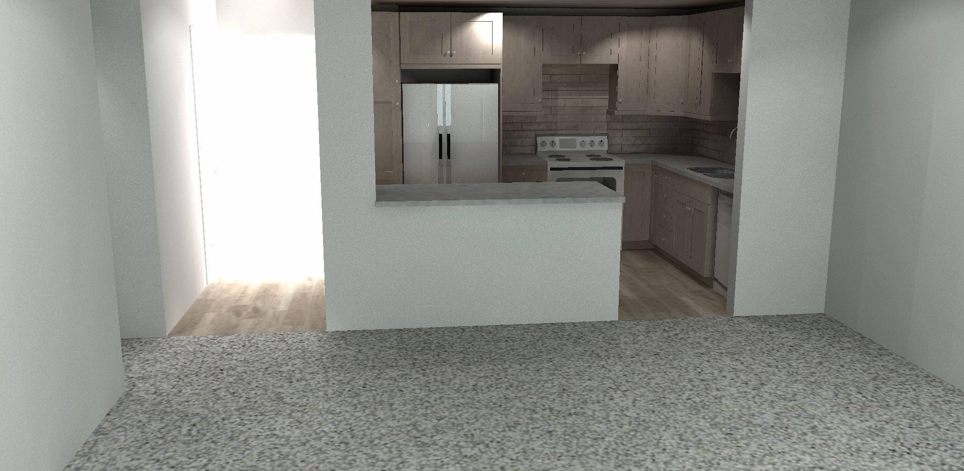

High Quality Rendering Glowing Doors To Parent Forum April 26, 2018 at 10:43 am #183505 Tim FieldingParticipant When I render a design using the high quality rendering feature my doors show up like they are the glowing entrance to the afterlife. I’ve tried to adjust the exposure, reset the ambient lighting and move the sun placement. Any Ideas on how to fix the issue. Attachments:Rendering-issue.jpg April 26, 2018 at 1:09 pm #183853 Neil WilsonParticipant Hey Tim, I know I’m not stepping through that portal! Which door from which catalog is it and which version of 2020 are you running? Neil April 26, 2018 at 1:52 pm #183904 Tim FieldingParticipant Hey Neil, I’m using the DOOR.ENT.WH.SQ.RAI from the Generic Room Catalog in version 11.9. April 26, 2018 at 2:53 pm #183918 Neil WilsonParticipant Hey Tim, Try this: right click on the door. Select light properties. Set the light color to Black. Redo the rendering. Let me know how it turns out. Neil April 26, 2018 at 3:42 pm #183922 Tim FieldingParticipant That Did the trick. Thanks Neil! You must be logged in to reply to this topic. Topic Tagsrendering Share this Post
