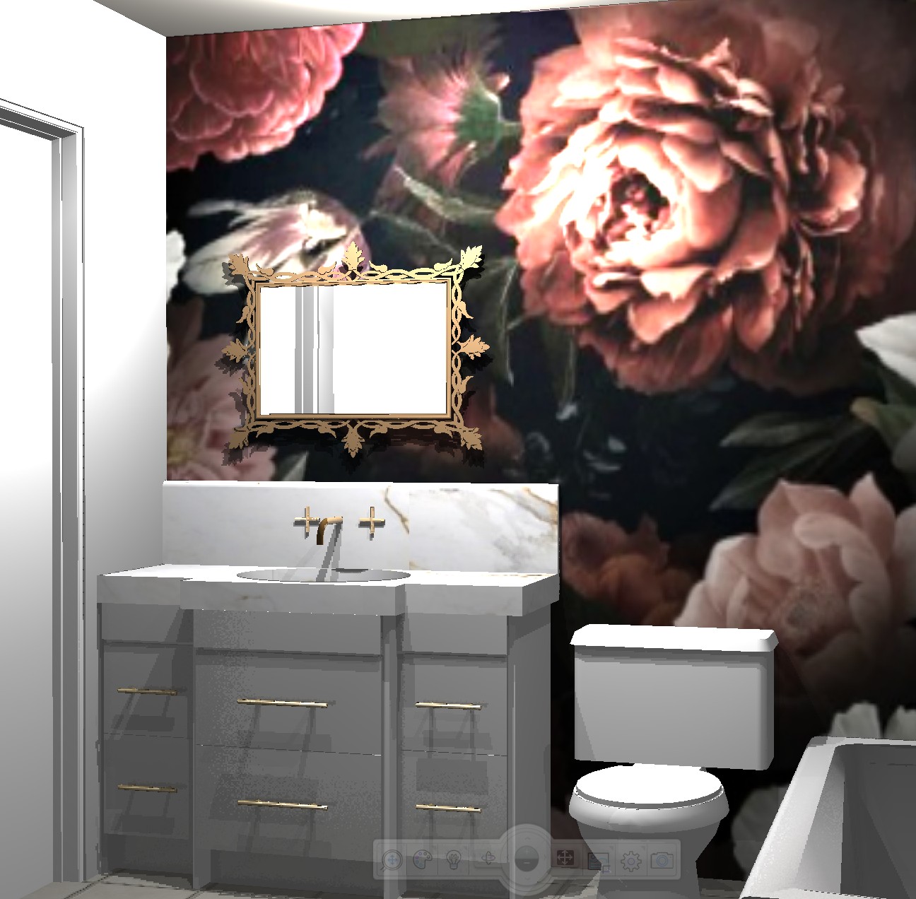

Elaine Sommerville
ParticipantYou can change the size of the texture to help avoid this when you “create a texture”. Additionally I am finding that importing CAD Textures from free sites is working quite well. Good luck! This is some wall paper I found. See attachment.
