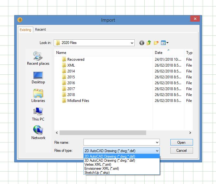

ParticipantQUESTION: Can you import DWG or DFX files into 2020?
July 5, 2018 at 8:40 pm #193666
Mike LangensiepenPilot ProSure is – go to File, Import and pick the option you want. There are obviously limitations as to how successful the import is and I’ve sometimes found it better to import the DXF/DWG into Sketchup, ‘fix’ anything that needs fixing, save it as a Sketchup file and import that.
