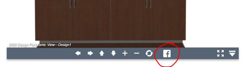

April 23, 2018 at 10:01 am #182948Neil WilsonParticipant
Hey Mike,
When you are generating the 360 you need to put a check in the Facebook box. That part you know 🙂 Then when the 360 is generated a link is sent. When you open the link to the 360 there is the Facebook F in the panorama’s toolbar. Click the F and a popup comes up that will ask you for a comment on the picture, to log in and to post it.

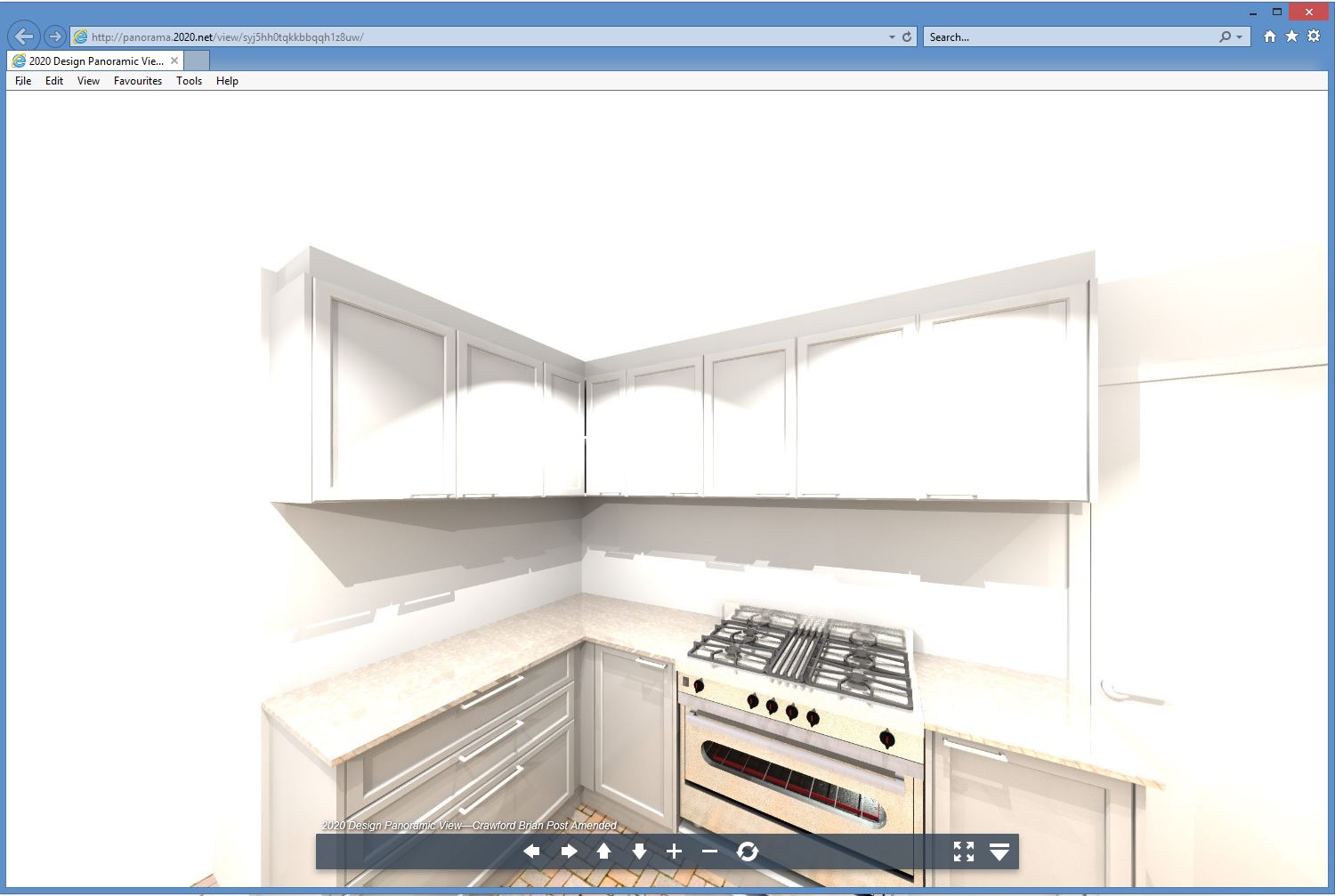

April 23, 2018 at 8:22 pm #183114Mike LangensiepenPilot Pro
Hi Neil,
I know my sight leaves a lot to be desired but it isn’t selective! lol I’ve attached some screen captures of the process and for the life of me, I can’t see a facebook ‘f’ anywhere!
I’ve tried 3 different browsers. What am I doing wrong?
Mike
April 24, 2018 at 9:54 am #183216Neil WilsonParticipant
Hey Mike,
Definitely something going on. The attached file shows what it’s supposed to look like.

April 26, 2018 at 7:38 pm #183944Mike LangensiepenPilot Pro
I’ll try it on a different PC – as you know, mine is doing some odd things.
April 26, 2018 at 9:17 pm #183945Mike LangensiepenPilot Pro
Yup – it’s down to my machine – the Facebook option popped up when I rendered on a different PC.
