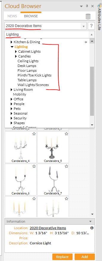

You can also find other lights in the cloud. Search in ‘2020 Decorative Items’ catalog, go to the ‘Lighting’ category, and look for the light you would like to use.
