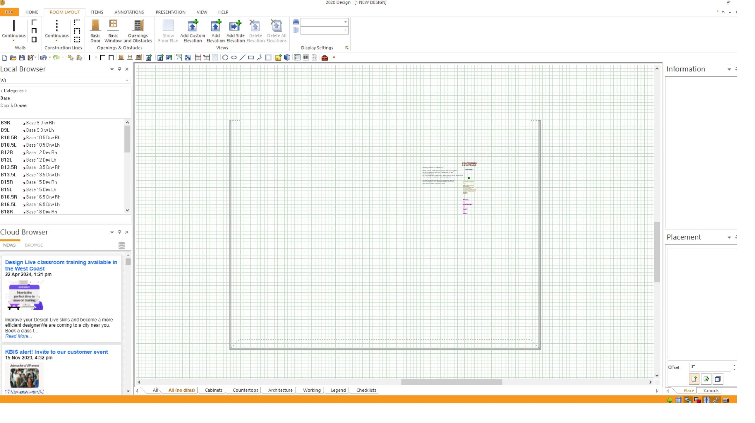

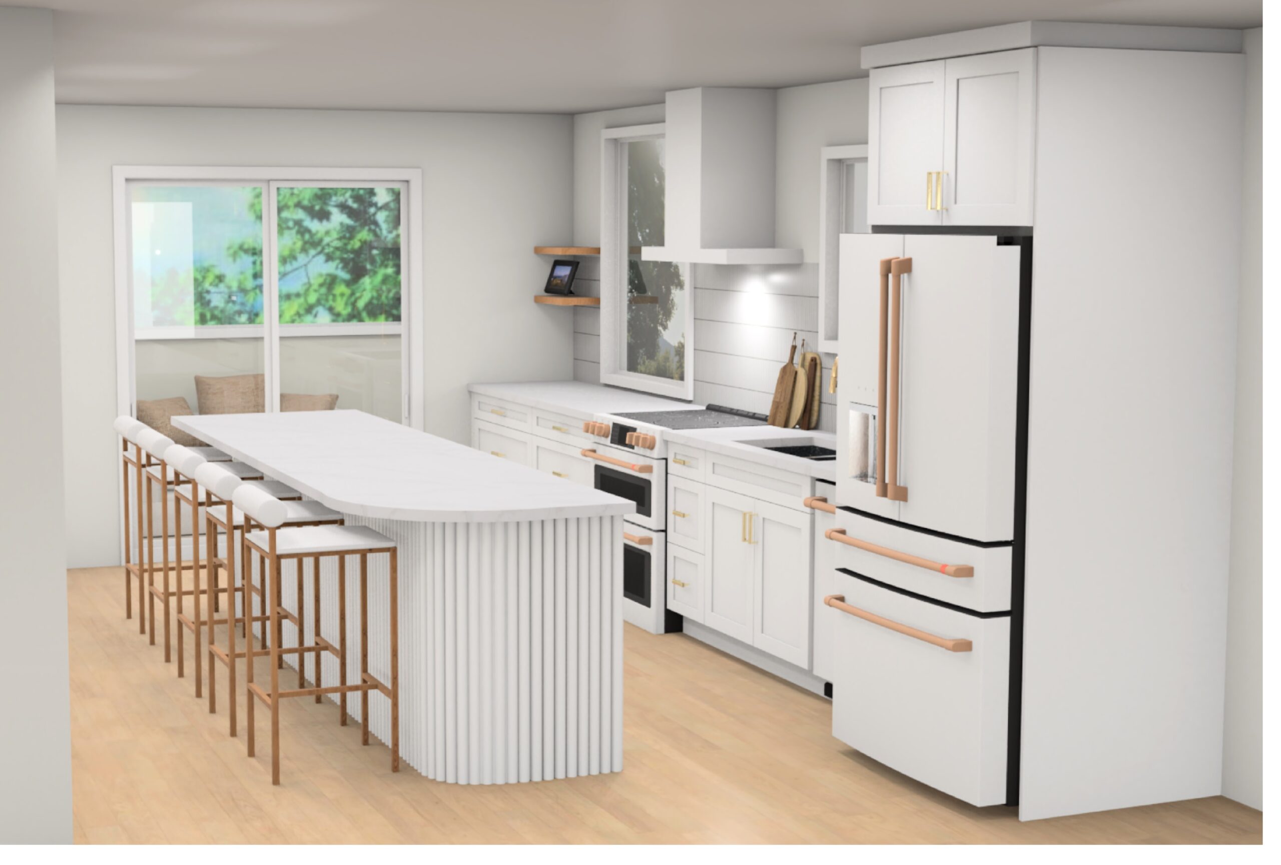

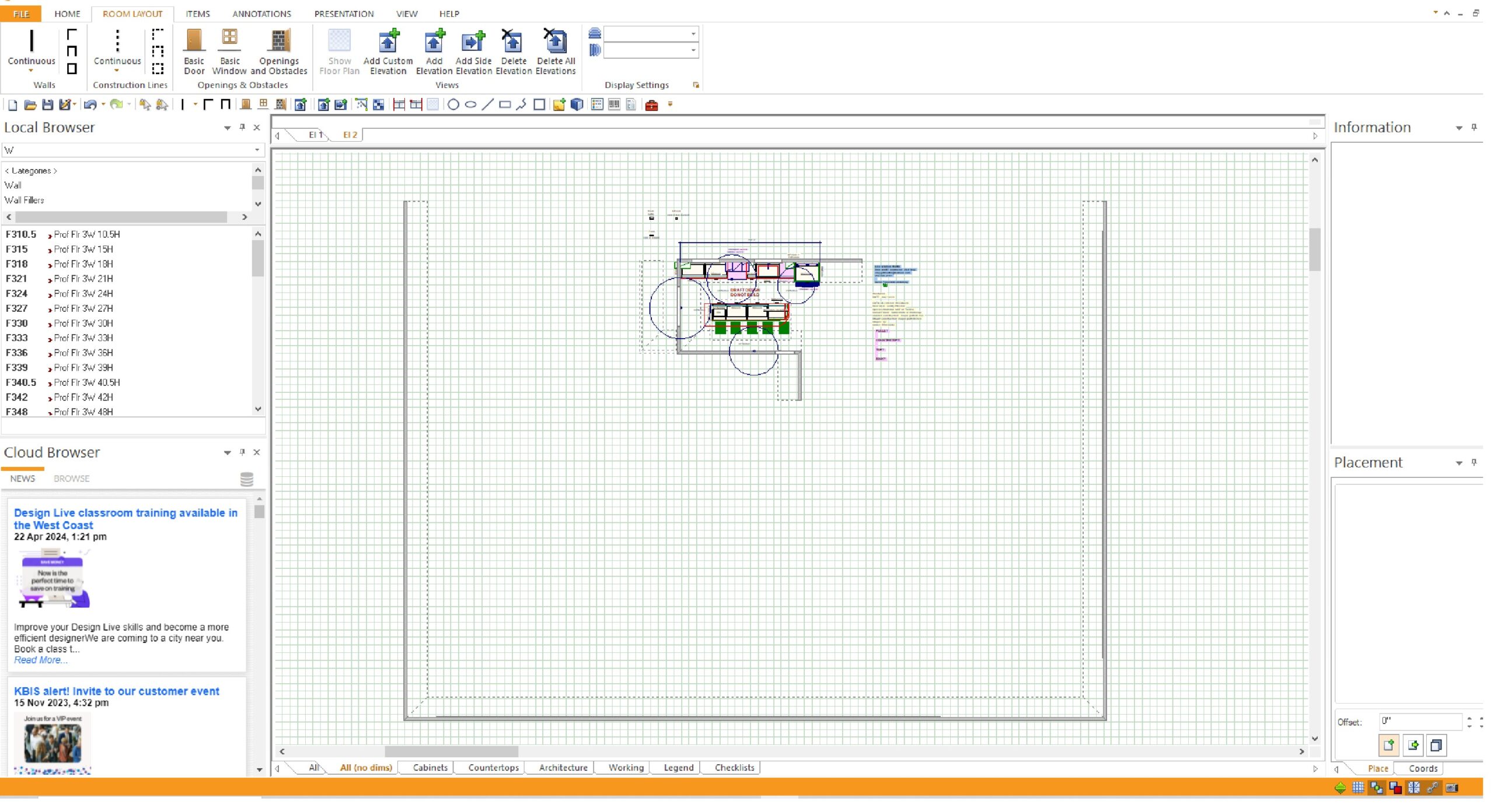

      I found that the renders rely HEAVILY on windows in the room for the light.   So I have a “blank” design with a HUUUUGE 3-sided room with a giant window on each wall saved on the floorplan.  When I want to start a design, I open that, rename it, and put the walls for my kitchen inside that giant room. Works well.
      I’ve attached a view of the “blank”, az view of one of my designs inside the blank, and a render. The render is using NO ADDED LIGHTS. Just the ambient light from the windows.
